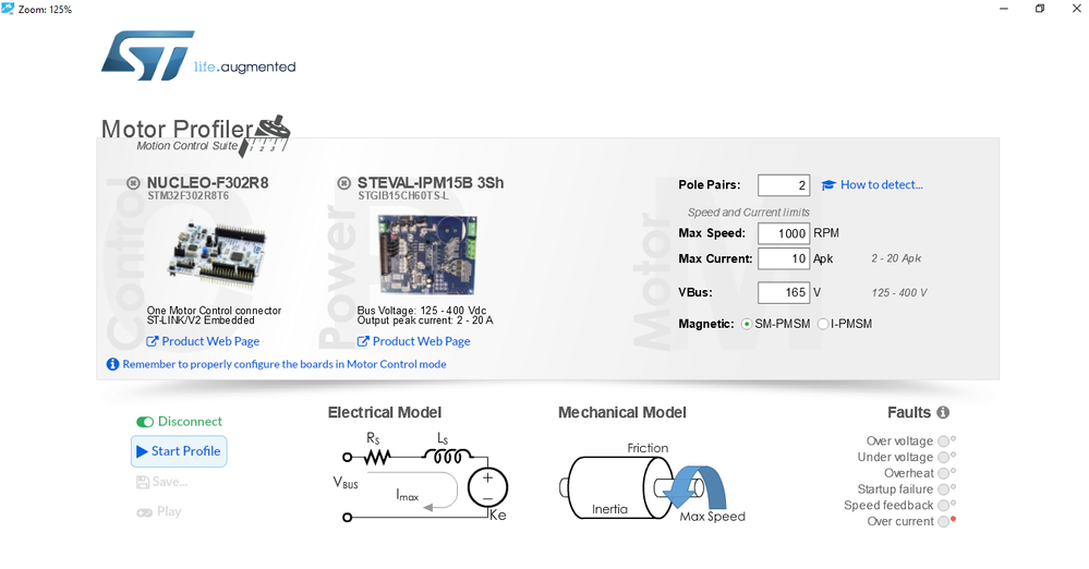

I tried with Motor Profiler. In over current small dot shows red and profile failed.
With same configurations i tried once & motor runs a bit.

2020-11-03 12:26 AM
2020-11-03 12:26 AM
Hello Just Zoom the corner Faults Section, Its due to External SMPS???

2020-11-03 12:28 AM
When i press start profile to set the profile at that time process few seconds & then goes into over current fault with small dot showing red.

I see from the screenshot the board selected in the profiler is IPM15B.
However you mentioned that you have a IPM20B. Do you confirm ?
If so, consider that the two boards are different, so maybe it could be the cause of this issue.
Moreover, even without any error, using a different board bring to an incorrect profiling of the motor values.
2020-12-01 8:36 AM
Yes you are right i used IPM20B instead of IPM15B.
I agree with your feedback with using IPM15B. but motor once runs for few seconds.
