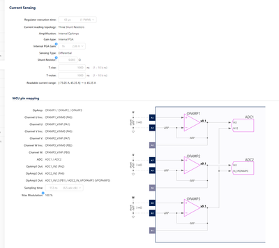

According to User Manual documentation available through "Workbench tool">About>Documentations>Documentation>"User manual", "7. Known Problems" Chapter in "Motor Profiler Application Note" link, "Progress execution bar stays at 7%" could be linked to ADC number usage.
Are you using a B-G431B-ESC1 standard board or a customized one? Standard board is using two ADCs...
2024-11-27 9:12 AM
I finally found your documentation. Thanks.
I'm using B-G431B-ESC1 standard board. If needed, it's revision C.
And 2 adcs seems to be configured as requested in the above documentation.
Generated CubeMx file seems to be correct according to the above screenshot.

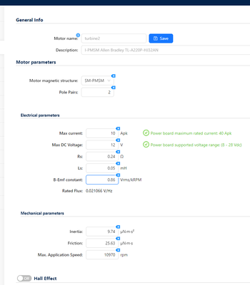

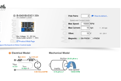

Hi
So, I put this settings:
into MCW:
Which leads to this json file :
"hardwareFamily": "MOTOR",
"label": "turbine2",
"description": "Turbine",
"polePairs": 2,
"nominalCurrent": 10,
"nominalDCVoltage": 12,
"rs": 0.24,
"ls": 0.05,
"magneticStructure": {
"type": "SM-PMSM"
"BEmfConstant": 0.86,
"inertia": 9.74,
"friction": 25.63,
"maxRatedSpeed": 10970,
"compatibility": ["FOC", "sixStep"],
"id": "turbine2"

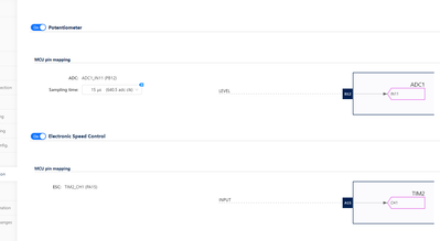

}I activated potentiometer and electronic speed control which settings are coherent with schematic:
Now when I click the button on the board to start the motor, the behaviour looks like while profiling:
https://youtube.com/shorts/QNHE1RNi2oE

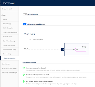

Hello @JulienD,
I am sorry but I missed one point, the "beep-beep" is coming from the fact that Electronic Speed Control ESC is enabled:
Could you please try disabling it?
Electronic Speed Control is described in UM2516: Electronic speed controller Discovery kit for drones with STM32G431CB.
