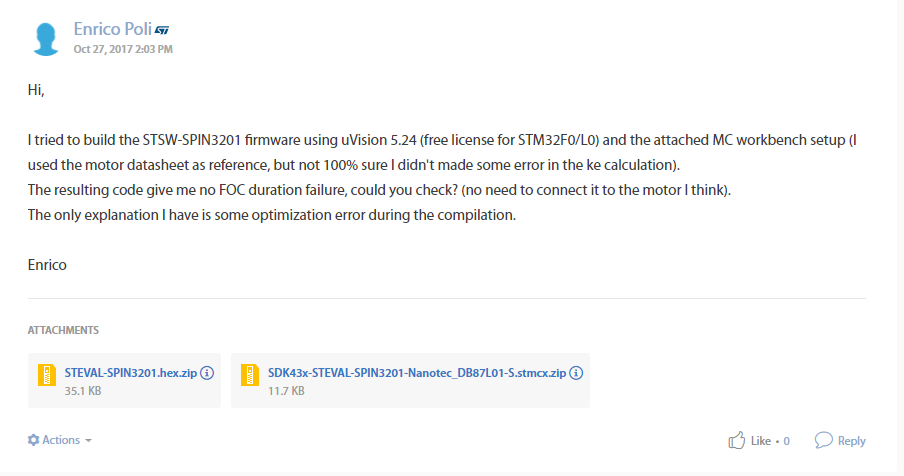

I tried to build the STSW-SPIN3201 firmware using uVision 5.24 (free license for STM32F0/L0) and the attached MC workbench setup (I used the motor datasheet as reference, but not 100% sure I didn't made some error in the ke calculation).
The resulting code give me no FOC duration failure, could you check? (no need to connect it to the motor I think).
The onlyexplanation I have is some optimization error during the compilation.
Enrico
________________ Attachments : SDK43x-STEVAL-SPIN3201-Nanotec_DB87L01-S.stmcx.zip : https://st--c.eu10.content.force.com/sfc/dist/version/download/?oid=00Db0000000YtG6&ids=0680X000006Hy9K&d=%2Fa%2F0X0000000b6L%2FfKyr24vOR2_KmXqsh98BOZFo2kt6z4_Hy4jB9KyIdEc&asPdf=falseSTEVAL-SPIN3201.hex.zip : https://st--c.eu10.content.force.com/sfc/dist/version/download/?oid=00Db0000000YtG6&ids=0680X000006HyLY&d=%2Fa%2F0X0000000b6I%2FUeReH2fzszJM1iNQfk09P9QlJYlwBhTLtNDo2.yOi8o&asPdf=false2017-10-30 2:30 AM

The attachments should be visible in the bottom of my reply.
You can upload attachments using the advanced editor (upper right corner in the reply box).
2017-10-30 8:17 AM
By the way... the attachments are not visible in the forum stream, you must open the
