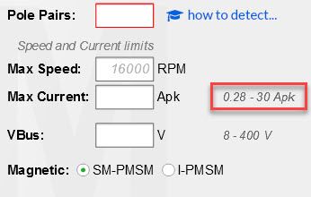

we already tuned the motor at 0.28 Apk. This value is given as a minimum by the Profiler utility:
Did you use a max current < 0.28 Apk? What are your motor specs?

2017-10-10 2:23 PM
OK, you are not hitting the minimum Apk. Which is different compared to my application.
2017-10-12 12:57 PM
Selected a BLDC motor which is running at 0.33 Apk which is higher then the minimum of 0.28 Apk. Profiling successfully within 10 seconds. Problem solved.
