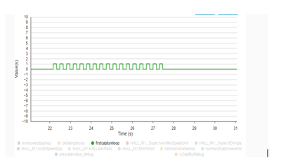

Finally I figured out the Jerk issue there is a bug in the code in the file hall_speed_pos_fdbk.c
/* Discard first capture */
if (0U == pHandle->FirstCapt)
pHandle->FirstCapt++;
(void)LL_TIM_IC_GetCaptureCH1(TIMx);
}we are discarding the first capture, But in the
__weak void *HALL_TIMx_UP_IRQHandler(void *pHandleVoid)
/* Reset first capture flag */
pHandle->FirstCapt = 0U;
}When the load is high the Hall timer overflow is happening and the FirstCapt variable is resetting to 0 and every time the Input capture considers it as first pulse and does not process.
The above is the debug variable i have added in the code and verified that it stays in the loop. I have commented the code and it works fine. My only question is can we consider all the pulses without discarding, since i feel that one pulse also has some impact. Request ST team to confirm if the above solution is correct and i can proceed with the change and thank you for support.

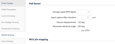

Did you notice if modifying the input capture filter duration has an impact on the jerk behavior?
