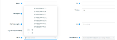

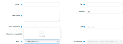

We are working for a project on Railway application, where we have selected STM32G4A1VET6 controller for Motor control application.
we are developing custom board for Motor control application, Selected motor is BG65x50 dCore by Dunker motor,
above selected controller is not available in MC workbench software. Could you please provide solution on this one and also the motor control library package is not available in STM32CUBE IDE middleware section.

Hello @VINODC,
This is the MCU STM32G4A1VETx.json description file to be added in your "MC_SDK_x.x.x\Utilities\PC_Software\STMCWB\assets\hardware\mcu" directory.
