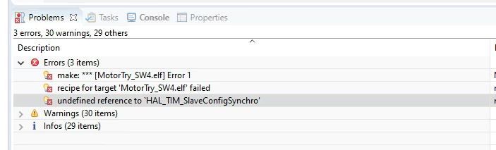

So I decided to install System Workbench for STM32 (SW4). Looks similar like the CubeIDE.
Of course, I deleted the CubeIDE, all folders.
The toolchain from mcsdk -> CubeMX -> SW4 works perfect, but if I build the project, error messages appears !
HAL problems ect. I think libraries are missing. Can somebody help me please ?
I tested both Firmware Package Versions: V1.10.0 & V1.11.0

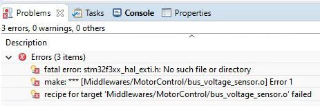

stm32f3xx_hal_exti.h is part of STM32Cube Firmware Library. By default these files are installed in %USERNAME%/STM32Cube/Repository/ STM32Cube_FW_F*_V*, where the asterick is for the version of the firmware being used, for example, the latest is for STM32F3xyz is STM32Cube_FW_F3_V1.11.0. When you ran Workshop, it asked you whave version of the Firmware that you would be using and the project that it generated should have copied the files from the Repository to your project under the Drivers folder. I just ran a test case with SW4 and in the project folders is "Drivers/STM32Gxx_HAL_Driver/Inc" which includes the *.exti.h file in question. If the file isn't there for some reason, just put it there manually from the Firmware Repository files.
So you should check that you have the correct version of the firmware installed for your target processor AND
that the Workshop generated project has a path/link defined to this specific include folder. It should show up under "Drivers" in the Project Explorer. You can right click "properties" of the resource in the Project Explorer and it will show you the path to that resource.
Note: When you run code generator from Workshop, after it is complete if you click on the text on the screen it will open a log file with all of the test that provides a detailed description of what it was doing. Much of this is Java template generation, but the end of it includes the folder paths for the source and header files. This can be useful for debugging if you have to get into the details.
2019-10-29 1:29 PM
I agree with you, but other manufacturers also offer free software. The problem is that i am running out of time, because this is part of my thesis, and without automatic code generation this topic alone would be a thesis. I am instructed that the qc generation works, otherwise I have a problem and not a small one. but I am very grateful to the support here in the community :)
I have added the stm32f3xx_hal_exti.h & stm32f3xx_hal_exti.c , but these files i found in F1.11.0 directory and not in the F1.10.0 directory.
In MCSCK i use Firmware 1.10.0 ! And not 1.11.0.
again, new errors, and that is the point...
In the appendix the logfile.

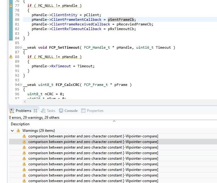

And if i try to build the generated SC with SW4 and Nucleo L476RG i get only pointer warnings, how can i fix it ?

According to ST, you should use the firmware F1.10 for Nucleo-F3 boards, but this causes the known errors.
But with the firmware F1.11 not, there are only pointer warnings, which you can ignore for now, usually not.
