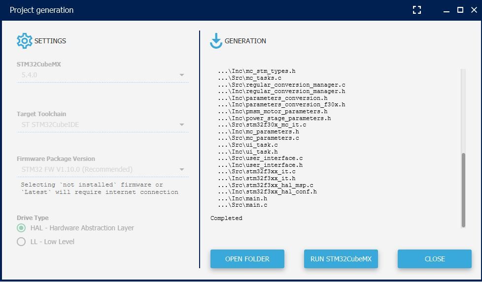

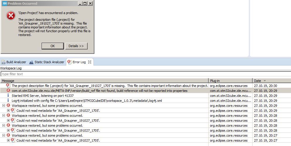

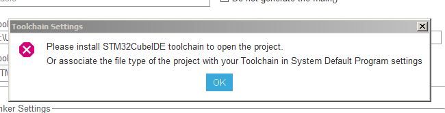

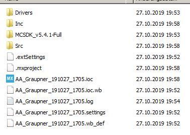

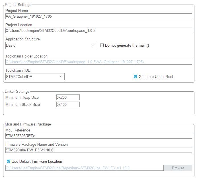

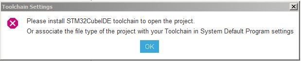

Now I want to use the MotorControl Workbench 5.4.1 FULL, to generate the source code for the STM32CubeIDE, but i get a toolchain error message. If I open the project in the IDE appears following error, in the approach are screenshots from my proceed.
I tried to use the codegeneration for True Studio in the STCubeIDE, without success.

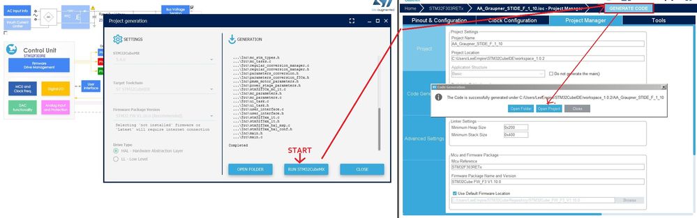

In Motor Control Workbench
[Run Cube MX]
Options in Cube MX
[Generate Code] -> [Open Project]
Project folder
Open STMCubeIDE and the project.

According to ST, you should use the firmware F1.10 for Nucleo-F3 boards, but this causes the known errors.
But with the firmware F1.11 not, there are only pointer warnings, which you can ignore for now, usually not.

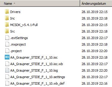

According your snapshots sounds obvious [Generate Code] -> [Open project] cannot work because lacking .project & .cproject files which are IDE (Eclipse in fact) prioprietary and mandatory ones. By the way still according your snapshots STM32CubeIDE repository doesn't exist at all …. ??
Your issue is why such files / directory are not generated ? … maybe tool suite install issue ...
What's sounds more weird is TrueStudio generation is not working …

I have looked at your link and followed the following instructions:
But the same problem:
Meanwhile, I'm already doing almost 2 complete days around it !

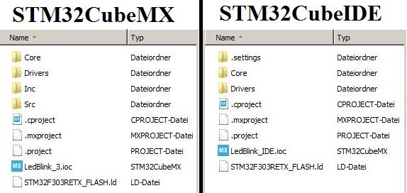

(edit) Definitely lies the problem on the Cube MX, I can only execute the LED blink example, if I create the project directly in the CubeIDE. When I open Cube MX and use code generate, it also comes the toolchain problem ...
(edit)
______________[not build]__________________________________________________ [not build]
