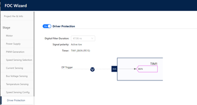

On your custom board, do you have enabled the Driver Protection linked to PE15 MCU input.
Refer to stspin32g4 datasheet, nFAULT chapter for more detail.
