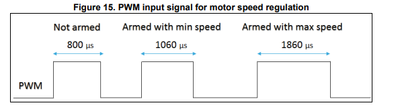

If you want to use the "electronic speed controller" of this board:
The electronic speed control (ESC) feature allows to control the motor speed with a PWM signal in input, for example on the B-G431B-ESC1 boards it is possible to use this feature to control the motors of a drone sending a PWM signal with a different duty cycle to switch the motor to armed, armed with a minimum speed, armed with a maximum speed and unarmed state.
You can find more details on this example on this link : click here
on the chapter "Connection and first execution of the electronic speed controller (ESC) program"

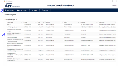

otherwise, you can generate a project by pressing "new project" in the workbench, import your profiled motor, generate and flash the project and control your motor with the Motor Pilot
2023-06-26 12:55 AM
Hello, can you try with the MCSDK 6.1.2, first launch the motor Pilot, then select the Motor Profiler, profile your motor, save this profiled motor, then launch the Workbench, select your Inverter, then load it saved motor, make the necessary configuration, and try with the generated firmware.

Did you use the default project (number one) or generate a new project (number 2)?
2023-06-26 1:21 AM
I used the default project
2023-06-26 2:14 AM
I understand. I will try to build a new project. Thanks for the reply
