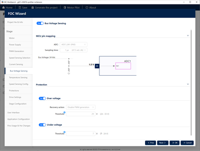

I am having issue to find a work around this parameter.
I do not specifically set any over voltage threshold but it seems to be present there already, so i am guessing that's something hard wired by ST.
Is there a way, other than changing manually to change this value?
Thanks in advance.
2023-06-26 5:06 AM
Hello, the 2 values of OV_VOLTAGE_THRESHOLD_V and UD_VOLTAGE_THRESHOLD_V are those defined in the MC WorkBench, you can modify them otherwise they are entered by default.
In the tab "Bus Voltage Sensing" on workbench
