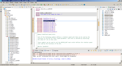

Im currently tring to program my nucleo-f103rb module. I have succesfully generated Motor control workbench project and CubeMx project. After code generation using cubemx , stm32cubeide1.8.0 opens the project code. Without changing anyting on the code , i pressed debug and 17 errors accured. I will share build console respons below.
Build console:
17:41:05 **** Incremental Build of configuration Debug for project stm32f103rb_son ****
make -j8 all
arm-none-eabi-gcc "../MotorControl/App/motorcontrol.c" -mcpu=cortex-m3 -std=gnu11 -g3 -DDEBUG -DUSE_HAL_DRIVER -DSTM32F103xB -c -I../MotorControl/App -I../MotorControl -I../Core/Inc -I../Drivers/STM32F1xx_HAL_Driver/Inc -I../Drivers/STM32F1xx_HAL_Driver/Inc/Legacy -I../MCSDK_v5.4.8-Full/MotorControl/MCSDK/MCLib/Any/Inc -I../MCSDK_v5.4.8-Full/MotorControl/MCSDK/MCLib/F1xx/Inc -I../MCSDK_v5.4.8-Full/MotorControl/MCSDK/UILibrary/Inc -I../MCSDK_v5.4.8-Full/MotorControl/MCSDK/SystemDriveParams -I../Drivers/CMSIS/Device/ST/STM32F1xx/Include -I../Drivers/CMSIS/Include -O0 -ffunction-sections -fdata-sections -Wall -fstack-usage -MMD -MP -MF"MotorControl/App/motorcontrol.d" -MT"MotorControl/App/motorcontrol.o" --specs=nano.specs -mfloat-abi=soft -mthumb -o "MotorControl/App/motorcontrol.o"
arm-none-eabi-gcc "../MotorControl/dac_rctimer_ui.c" -mcpu=cortex-m3 -std=gnu11 -g3 -DDEBUG -DUSE_HAL_DRIVER -DSTM32F103xB -c -I../MotorControl/App -I../MotorControl -I../Core/Inc -I../Drivers/STM32F1xx_HAL_Driver/Inc -I../Drivers/STM32F1xx_HAL_Driver/Inc/Legacy -I../MCSDK_v5.4.8-Full/MotorControl/MCSDK/MCLib/Any/Inc -I../MCSDK_v5.4.8-Full/MotorControl/MCSDK/MCLib/F1xx/Inc -I../MCSDK_v5.4.8-Full/MotorControl/MCSDK/UILibrary/Inc -I../MCSDK_v5.4.8-Full/MotorControl/MCSDK/SystemDriveParams -I../Drivers/CMSIS/Device/ST/STM32F1xx/Include -I../Drivers/CMSIS/Include -O0 -ffunction-sections -fdata-sections -Wall -fstack-usage -MMD -MP -MF"MotorControl/dac_rctimer_ui.d" -MT"MotorControl/dac_rctimer_ui.o" --specs=nano.specs -mfloat-abi=soft -mthumb -o "MotorControl/dac_rctimer_ui.o"
arm-none-eabi-gcc "../MotorControl/mc_api.c" -mcpu=cortex-m3 -std=gnu11 -g3 -DDEBUG -DUSE_HAL_DRIVER -DSTM32F103xB -c -I../MotorControl/App -I../MotorControl -I../Core/Inc -I../Drivers/STM32F1xx_HAL_Driver/Inc -I../Drivers/STM32F1xx_HAL_Driver/Inc/Legacy -I../MCSDK_v5.4.8-Full/MotorControl/MCSDK/MCLib/Any/Inc -I../MCSDK_v5.4.8-Full/MotorControl/MCSDK/MCLib/F1xx/Inc -I../MCSDK_v5.4.8-Full/MotorControl/MCSDK/UILibrary/Inc -I../MCSDK_v5.4.8-Full/MotorControl/MCSDK/SystemDriveParams -I../Drivers/CMSIS/Device/ST/STM32F1xx/Include -I../Drivers/CMSIS/Include -O0 -ffunction-sections -fdata-sections -Wall -fstack-usage -MMD -MP -MF"MotorControl/mc_api.d" -MT"MotorControl/mc_api.o" --specs=nano.specs -mfloat-abi=soft -mthumb -o "MotorControl/mc_api.o"
arm-none-eabi-gcc "../MotorControl/mc_config.c" -mcpu=cortex-m3 -std=gnu11 -g3 -DDEBUG -DUSE_HAL_DRIVER -DSTM32F103xB -c -I../MotorControl/App -I../MotorControl -I../Core/Inc -I../Drivers/STM32F1xx_HAL_Driver/Inc -I../Drivers/STM32F1xx_HAL_Driver/Inc/Legacy -I../MCSDK_v5.4.8-Full/MotorControl/MCSDK/MCLib/Any/Inc -I../MCSDK_v5.4.8-Full/MotorControl/MCSDK/MCLib/F1xx/Inc -I../MCSDK_v5.4.8-Full/MotorControl/MCSDK/UILibrary/Inc -I../MCSDK_v5.4.8-Full/MotorControl/MCSDK/SystemDriveParams -I../Drivers/CMSIS/Device/ST/STM32F1xx/Include -I../Drivers/CMSIS/Include -O0 -ffunction-sections -fdata-sections -Wall -fstack-usage -MMD -MP -MF"MotorControl/mc_config.d" -MT"MotorControl/mc_config.o" --specs=nano.specs -mfloat-abi=soft -mthumb -o "MotorControl/mc_config.o"
arm-none-eabi-gcc "../MotorControl/mc_interface.c" -mcpu=cortex-m3 -std=gnu11 -g3 -DDEBUG -DUSE_HAL_DRIVER -DSTM32F103xB -c -I../MotorControl/App -I../MotorControl -I../Core/Inc -I../Drivers/STM32F1xx_HAL_Driver/Inc -I../Drivers/STM32F1xx_HAL_Driver/Inc/Legacy -I../MCSDK_v5.4.8-Full/MotorControl/MCSDK/MCLib/Any/Inc -I../MCSDK_v5.4.8-Full/MotorControl/MCSDK/MCLib/F1xx/Inc -I../MCSDK_v5.4.8-Full/MotorControl/MCSDK/UILibrary/Inc -I../MCSDK_v5.4.8-Full/MotorControl/MCSDK/SystemDriveParams -I../Drivers/CMSIS/Device/ST/STM32F1xx/Include -I../Drivers/CMSIS/Include -O0 -ffunction-sections -fdata-sections -Wall -fstack-usage -MMD -MP -MF"MotorControl/mc_interface.d" -MT"MotorControl/mc_interface.o" --specs=nano.specs -mfloat-abi=soft -mthumb -o "MotorControl/mc_interface.o"
arm-none-eabi-gcc "../MotorControl/mc_math.c" -mcpu=cortex-m3 -std=gnu11 -g3 -DDEBUG -DUSE_HAL_DRIVER -DSTM32F103xB -c -I../MotorControl/App -I../MotorControl -I../Core/Inc -I../Drivers/STM32F1xx_HAL_Driver/Inc -I../Drivers/STM32F1xx_HAL_Driver/Inc/Legacy -I../MCSDK_v5.4.8-Full/MotorControl/MCSDK/MCLib/Any/Inc -I../MCSDK_v5.4.8-Full/MotorControl/MCSDK/MCLib/F1xx/Inc -I../MCSDK_v5.4.8-Full/MotorControl/MCSDK/UILibrary/Inc -I../MCSDK_v5.4.8-Full/MotorControl/MCSDK/SystemDriveParams -I../Drivers/CMSIS/Device/ST/STM32F1xx/Include -I../Drivers/CMSIS/Include -O0 -ffunction-sections -fdata-sections -Wall -fstack-usage -MMD -MP -MF"MotorControl/mc_math.d" -MT"MotorControl/mc_math.o" --specs=nano.specs -mfloat-abi=soft -mthumb -o "MotorControl/mc_math.o"
arm-none-eabi-gcc "../MotorControl/mc_parameters.c" -mcpu=cortex-m3 -std=gnu11 -g3 -DDEBUG -DUSE_HAL_DRIVER -DSTM32F103xB -c -I../MotorControl/App -I../MotorControl -I../Core/Inc -I../Drivers/STM32F1xx_HAL_Driver/Inc -I../Drivers/STM32F1xx_HAL_Driver/Inc/Legacy -I../MCSDK_v5.4.8-Full/MotorControl/MCSDK/MCLib/Any/Inc -I../MCSDK_v5.4.8-Full/MotorControl/MCSDK/MCLib/F1xx/Inc -I../MCSDK_v5.4.8-Full/MotorControl/MCSDK/UILibrary/Inc -I../MCSDK_v5.4.8-Full/MotorControl/MCSDK/SystemDriveParams -I../Drivers/CMSIS/Device/ST/STM32F1xx/Include -I../Drivers/CMSIS/Include -O0 -ffunction-sections -fdata-sections -Wall -fstack-usage -MMD -MP -MF"MotorControl/mc_parameters.d" -MT"MotorControl/mc_parameters.o" --specs=nano.specs -mfloat-abi=soft -mthumb -o "MotorControl/mc_parameters.o"
arm-none-eabi-gcc "../MotorControl/mc_tasks.c" -mcpu=cortex-m3 -std=gnu11 -g3 -DDEBUG -DUSE_HAL_DRIVER -DSTM32F103xB -c -I../MotorControl/App -I../MotorControl -I../Core/Inc -I../Drivers/STM32F1xx_HAL_Driver/Inc -I../Drivers/STM32F1xx_HAL_Driver/Inc/Legacy -I../MCSDK_v5.4.8-Full/MotorControl/MCSDK/MCLib/Any/Inc -I../MCSDK_v5.4.8-Full/MotorControl/MCSDK/MCLib/F1xx/Inc -I../MCSDK_v5.4.8-Full/MotorControl/MCSDK/UILibrary/Inc -I../MCSDK_v5.4.8-Full/MotorControl/MCSDK/SystemDriveParams -I../Drivers/CMSIS/Device/ST/STM32F1xx/Include -I../Drivers/CMSIS/Include -O0 -ffunction-sections -fdata-sections -Wall -fstack-usage -MMD -MP -MF"MotorControl/mc_tasks.d" -MT"MotorControl/mc_tasks.o" --specs=nano.specs -mfloat-abi=soft -mthumb -o "MotorControl/mc_tasks.o"
In file included from ../MCSDK_v5.4.8-Full/MotorControl/MCSDK/MCLib/Any/Inc/mc_type.h:56,
from ../MotorControl/user_interface.h:31,
from ../MCSDK_v5.4.8-Full/MotorControl/MCSDK/UILibrary/Inc/dac_rctimer_ui.h:25,
from ../MotorControl/dac_rctimer_ui.c:26:
../MotorControl/mc_stm_types.h:30:12: fatal error: stm32f1xx_ll_rcc.h: No such file or directory
30 | #include "stm32f1xx_ll_rcc.h"
compilation terminated.
make: *** [MotorControl/subdir.mk:52: MotorControl/dac_rctimer_ui.o] Error 1
make: *** Waiting for unfinished jobs....
from ../MotorControl/mc_interface.h:31,
from ../MotorControl/mc_api.c:20:
from ../MotorControl/mc_math.h:28,
from ../MotorControl/mc_interface.c:24:
make: *** [MotorControl/subdir.mk:52: MotorControl/mc_api.o] Error 1
from ../MotorControl/mc_math.c:22:
make: *** [MotorControl/subdir.mk:52: MotorControl/mc_interface.o] Error 1
make: *** [MotorControl/subdir.mk:52: MotorControl/mc_math.o] Error 1
from ../MCSDK_v5.4.8-Full/MotorControl/MCSDK/MCLib/Any/Inc/pid_regulator.h:27,
from ../MotorControl/mc_config.h:24,
from ../MotorControl/App/motorcontrol.h:24,
from ../Core/Inc/main.h:31,
from ../MotorControl/App/motorcontrol.c:19:
make: *** [MotorControl/App/subdir.mk:19: MotorControl/App/motorcontrol.o] Error 1
from ../MotorControl/mc_parameters.c:24:
from ../MotorControl/mc_config.c:19:
make: *** [MotorControl/subdir.mk:52: MotorControl/mc_config.o] Error 1
make: *** [MotorControl/subdir.mk:52: MotorControl/mc_parameters.o] Error 1
from ../MotorControl/mc_tasks.c:23:
make: *** [MotorControl/subdir.mk:52: MotorControl/mc_tasks.o] Error 1
"make -j8 all" terminated with exit code 2. Build might be incomplete.
17:41:06 Build Failed. 17 errors, 0 warnings. (took 644ms)
I had using old version of stm32cubeide and today i deleted old one and installed newer version 1.8.0 becuase i saw this errors. I thought newer version will solve this but no luck. I m using;
MotorControl Workbench 5.4.8
STM32CubeMX version 6.4.0
STM32CubeIDE 1.8.0
with win 7 os.
Please help.

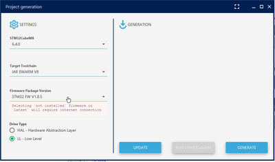

2024-03-18 2:42 AM

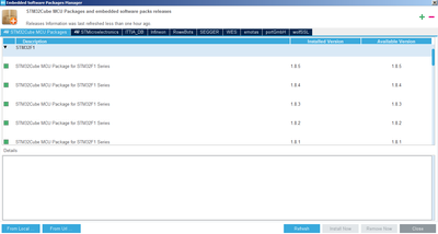

Could you please check that a Firmware Package Version is available when generating project:
You can download it through CubeMx>Help>"Manage embedded software packages">STM32F1

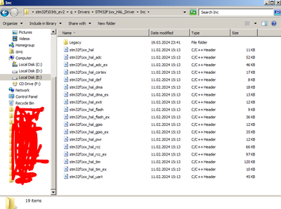

stm32f1xx_ll_rcc.h should be present in "Project\Drivers\STM32F1xx_HAL_Driver\Inc" directory.

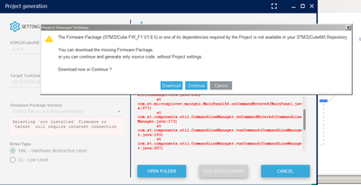

Hi.
I just check it and there are some other problems about generating and debuggin.

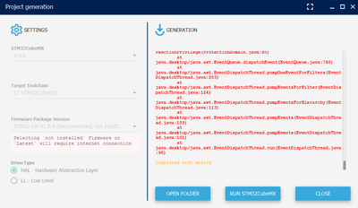

Firstly when generation project using motor control workbench 5.4.8 software gives some error about java . I will share here screenshot and complete error code.
here is the complete output data of the errors;
2024-03-19 23:39:02,726 ERROR [LineInfo_to_exitCode.log_LineInfo] The ST intranet updater server is unknown: mcucrossselector.codex.cro.st.com
2024-03-19 23:39:33,122 ERROR [LineInfo_to_exitCode.log_LineInfo] java.lang.IndexOutOfBoundsException: Index 0 out of bounds for length 0
2024-03-19 23:39:33,123 ERROR [LineInfo_to_exitCode.log_LineInfo] at java.base/jdk.internal.util.Preconditions.outOfBounds(Preconditions.java:64)
2024-03-19 23:39:33,123 ERROR [LineInfo_to_exitCode.log_LineInfo] at java.base/jdk.internal.util.Preconditions.outOfBoundsCheckIndex(Preconditions.java:70)
2024-03-19 23:39:33,124 ERROR [LineInfo_to_exitCode.log_LineInfo] at java.base/jdk.internal.util.Preconditions.checkIndex(Preconditions.java:248)
2024-03-19 23:39:33,124 ERROR [LineInfo_to_exitCode.log_LineInfo] at java.base/java.util.Objects.checkIndex(Objects.java:372)
2024-03-19 23:39:33,125 ERROR [LineInfo_to_exitCode.log_LineInfo] at java.base/java.util.ArrayList.get(ArrayList.java:459)
2024-03-19 23:39:33,125 ERROR [LineInfo_to_exitCode.log_LineInfo] at java.desktop/javax.swing.JTabbedPane.setIconAt(JTabbedPane.java:1365)
2024-03-19 23:39:33,126 ERROR [LineInfo_to_exitCode.log_LineInfo] at com.st.microxplorer.maingui.MainPanel.setPluginError(MainPanel.java:445)
2024-03-19 23:39:33,126 ERROR [LineInfo_to_exitCode.log_LineInfo] at com.st.microxplorer.plugin.PluginView.setPluginError(PluginView.java:94)
2024-03-19 23:39:33,126 ERROR [LineInfo_to_exitCode.log_LineInfo] at com.st.microxplorer.plugins.pinoutandconfiguration.PinoutAndConfigurationView.propertyChange(PinoutAndConfigurationView.java:1000)
2024-03-19 23:39:33,127 ERROR [LineInfo_to_exitCode.log_LineInfo] at java.desktop/java.beans.PropertyChangeSupport.fire(PropertyChangeSupport.java:341)
2024-03-19 23:39:33,127 ERROR [LineInfo_to_exitCode.log_LineInfo] at java.desktop/java.beans.PropertyChangeSupport.firePropertyChange(PropertyChangeSupport.java:333)
2024-03-19 23:39:33,128 ERROR [LineInfo_to_exitCode.log_LineInfo] at com.st.microxplorer.util.MXPropertyChangeSupport.refreshing(MXPropertyChangeSupport.java:68)
2024-03-19 23:39:33,128 ERROR [LineInfo_to_exitCode.log_LineInfo] at com.st.microxplorer.mxsystem.MxSystem.refreshing(MxSystem.java:872)
2024-03-19 23:39:33,128 ERROR [LineInfo_to_exitCode.log_LineInfo] at com.st.microxplorer.plugins.ipmanager.gui.IPsOverviews.updateAllDiagram(IPsOverviews.java:2445)
2024-03-19 23:39:33,129 ERROR [LineInfo_to_exitCode.log_LineInfo] at com.st.microxplorer.plugins.ipmanager.pluginmanagement.IpPluginManagement.updateAllDiagram(IpPluginManagement.java:382)
2024-03-19 23:39:33,129 ERROR [LineInfo_to_exitCode.log_LineInfo] at com.st.microxplorer.plugins.ipmanager.IPPluginView.getSpecificTask(IPPluginView.java:349)
2024-03-19 23:39:33,129 ERROR [LineInfo_to_exitCode.log_LineInfo] at com.st.microxplorer.plugins.pinoutandconfiguration.PinoutAndConfigurationView.propertyChange(PinoutAndConfigurationView.java:956)
2024-03-19 23:39:33,130 ERROR [LineInfo_to_exitCode.log_LineInfo] at java.desktop/java.beans.PropertyChangeSupport.fire(PropertyChangeSupport.java:341)
2024-03-19 23:39:33,130 ERROR [LineInfo_to_exitCode.log_LineInfo] at java.desktop/java.beans.PropertyChangeSupport.firePropertyChange(PropertyChangeSupport.java:333)
2024-03-19 23:39:33,131 ERROR [LineInfo_to_exitCode.log_LineInfo] at java.desktop/java.beans.PropertyChangeSupport.firePropertyChange(PropertyChangeSupport.java:266)
2024-03-19 23:39:33,131 ERROR [LineInfo_to_exitCode.log_LineInfo] at java.desktop/java.awt.Component.firePropertyChange(Component.java:8731)
2024-03-19 23:39:33,131 ERROR [LineInfo_to_exitCode.log_LineInfo] at java.desktop/javax.swing.JComponent.removeNotify(JComponent.java:4805)
2024-03-19 23:39:33,132 ERROR [LineInfo_to_exitCode.log_LineInfo] at java.desktop/java.awt.Container.removeNotify(Container.java:2831)
2024-03-19 23:39:33,132 ERROR [LineInfo_to_exitCode.log_LineInfo] at java.desktop/javax.swing.JComponent.removeNotify(JComponent.java:4801)
2024-03-19 23:39:33,133 ERROR [LineInfo_to_exitCode.log_LineInfo] at java.desktop/java.awt.Container.removeNotify(Container.java:2831)
2024-03-19 23:39:33,133 ERROR [LineInfo_to_exitCode.log_LineInfo] at java.desktop/javax.swing.JComponent.removeNotify(JComponent.java:4801)
2024-03-19 23:39:33,134 ERROR [LineInfo_to_exitCode.log_LineInfo] at java.desktop/javax.swing.JComponent.removeNotify(JComponent.java:4801)
2024-03-19 23:39:33,134 ERROR [LineInfo_to_exitCode.log_LineInfo] at java.desktop/java.awt.Container.removeNotify(Container.java:2831)
2024-03-19 23:39:33,135 ERROR [LineInfo_to_exitCode.log_LineInfo] at java.desktop/javax.swing.JComponent.removeNotify(JComponent.java:4801)
2024-03-19 23:39:33,135 ERROR [LineInfo_to_exitCode.log_LineInfo] at java.desktop/java.awt.Container.removeNotify(Container.java:2831)
2024-03-19 23:39:33,136 ERROR [LineInfo_to_exitCode.log_LineInfo] at java.desktop/javax.swing.JComponent.removeNotify(JComponent.java:4801)
2024-03-19 23:39:33,136 ERROR [LineInfo_to_exitCode.log_LineInfo] at java.desktop/java.awt.Container.remove(Container.java:1231)
2024-03-19 23:39:33,136 ERROR [LineInfo_to_exitCode.log_LineInfo] at java.desktop/javax.swing.JTabbedPane.removeTabAt(JTabbedPane.java:1006)
2024-03-19 23:39:33,137 ERROR [LineInfo_to_exitCode.log_LineInfo] at java.desktop/javax.swing.JTabbedPane.removeAll(JTabbedPane.java:1075)
2024-03-19 23:39:33,137 ERROR [LineInfo_to_exitCode.log_LineInfo] at com.st.microxplorer.maingui.MainPanel.removePluginTabs(MainPanel.java:1515)
2024-03-19 23:39:33,137 ERROR [LineInfo_to_exitCode.log_LineInfo] at com.st.microxplorer.maingui.MainPanel.updateViewsTabPane(MainPanel.java:1520)
2024-03-19 23:39:33,138 ERROR [LineInfo_to_exitCode.log_LineInfo] at com.st.microxplorer.maingui.MainPanel.propertyChange(MainPanel.java:858)
2024-03-19 23:39:33,138 ERROR [LineInfo_to_exitCode.log_LineInfo] at java.desktop/java.beans.PropertyChangeSupport.fire(PropertyChangeSupport.java:341)
2024-03-19 23:39:33,138 ERROR [LineInfo_to_exitCode.log_LineInfo] at java.desktop/java.beans.PropertyChangeSupport.firePropertyChange(PropertyChangeSupport.java:333)
2024-03-19 23:39:33,139 ERROR [LineInfo_to_exitCode.log_LineInfo] at java.desktop/java.beans.PropertyChangeSupport.firePropertyChange(PropertyChangeSupport.java:266)
2024-03-19 23:39:33,139 ERROR [LineInfo_to_exitCode.log_LineInfo] at com.st.microxplorer.util.MXPropertyChangeSupport.firePropertyChange(MXPropertyChangeSupport.java:50)
2024-03-19 23:39:33,140 ERROR [LineInfo_to_exitCode.log_LineInfo] at com.st.microxplorer.mxsystem.MxSystem.swingWorkerCompleteLoadConfig(MxSystem.java:785)
2024-03-19 23:39:33,140 ERROR [LineInfo_to_exitCode.log_LineInfo] at com.st.microxplorer.util.ProcessBarDialog.performAction(ProcessBarDialog.java:89)
2024-03-19 23:39:33,140 ERROR [LineInfo_to_exitCode.log_LineInfo] at com.st.microxplorer.util.ProcessBarDialog.doAction(ProcessBarDialog.java:136)
2024-03-19 23:39:33,141 ERROR [LineInfo_to_exitCode.log_LineInfo] at com.st.microxplorer.mxsystem.MxSystem.completeLoadConfig(MxSystem.java:779)
2024-03-19 23:39:33,141 ERROR [LineInfo_to_exitCode.log_LineInfo] at com.st.microxplorer.plugins.filemanager.engine.OpenFileManager.LoadConfig(OpenFileManager.java:325)
2024-03-19 23:39:33,142 ERROR [LineInfo_to_exitCode.log_LineInfo] at com.st.microxplorer.plugins.filemanager.engine.OpenFileManager.loadConfigurationFile(OpenFileManager.java:242)
2024-03-19 23:39:33,142 ERROR [LineInfo_to_exitCode.log_LineInfo] at com.st.microxplorer.plugins.filemanager.engine.MainFileManager.userLoadConfig(MainFileManager.java:280)
2024-03-19 23:39:33,142 ERROR [LineInfo_to_exitCode.log_LineInfo] at com.st.microxplorer.plugins.filemanager.FileManagerView.getSpecificTask(FileManagerView.java:240)
2024-03-19 23:39:33,143 ERROR [LineInfo_to_exitCode.log_LineInfo] at com.st.microxplorer.maingui.MainPanel$4.onCommandEntered(MainPanel.java:977)

Those are only error outputs from project generation screen of mcsdk. It completes with error. Anyway when i with Run CubeMX , its opening and all pins are correct.
Without changing anything on the CubeMX and after type name of project and select output for STM32CubeIDE , i click to generate button. After that event , an error massage pops up and says;
After your succestion i have check the firmwares on the cubemx and 1.8.5 and 1.8.4 was already installed. For tring to find solution i also installed other firmware down to version 1.8.0. When i select to install version 1.8.0 , it tried to download and install but it gave and error message which it says, this version is already installed. you can see installed firmwares below;
Anyway, after cubemx warning massage , i have choosed YES and opened using cubeide software.
My cubeIDE is 1.8.0 version. Without changing anything on the code , i pressed the Debug button and 17 errors dissaperad. You can see below;
It seems when generating files , some files are missing or something. Also you can see the file that you have mentioned your last post below ;
Please help me for this. I cannot upload my code to the Nucleo board.

Firstly, could you please avoid copy/past in plain text the output compile errors and attach it in file to be easier to read.
Secondly could you please attach your stmcx file?

2024-03-21 9:28 AM
On my side, using WorkBench5.4.8, CubeMx6.4, F1 FW package1.8.4 and your test1.stmcx, project generation works.
Sound strange that a FW package1.8.5 message appears when 1.8.4 is the recommended one....
Then, could you please, un-install FW package STM32F1 1.8.5 using CubeMx interface Help>"Manage embedded firmware packages" clicking on 1.8.5 line, Select Remove.
Un-install CubeMx6.4 using windows "settings>Apps & features" tool.
Install CubeMx6.4, and generate a new project from a new directory.

Hello
Today, all day , i have tried to work this out but no luck. I have uninstalled and installed software including firmwares 4 times. Each of time i got weird different situations. I will tell you what i have got at least.
I have reinstalled all softwares ( mcsdk , cubeide, cubemx ) and all firmwares. I didn't manually install firmwares when i reinstall cubemx. I did generate project successfully using mcsdk at least. After generating successfully done , i have clicked to open cubemx blue button on mcsdk. Cubemx opened and now weird situations begins.

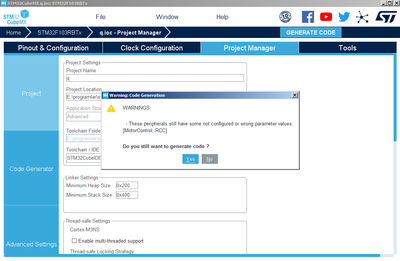

Without changing anything , i click to generate code button on cubemx and cubemx is asking me following things ;
1. Project name.
2.project location
The weird is , i have two computer that i have installed same softwares and softwares of stm32. At my home computer , they are working perfectly. I can generate code and all things without any error. But for my work computer , i m still trying to get it work.
When i click generate code on my home PC , cubemx doesn't ask me project name and location. But at my work PC , cubemx keep asking , it doesn't recognize although i came from mcsdk software.
Anyway when i select location of mcsdk output file and give same name of mcsdk project , i click to generate code on cubemx. When i click , it give warning message , " these peripherals still have some not configured or wrong parameter values: [motor control,RCC]. " Ot is also weird that because my home PC doesn't give this warning message at all.
Anyway i click to " no" and come back to pinout& configuration. I just click RCC and middleware>motorcontrol without changing anything then press to generate code button , boom it starts to generate code without previous warning message.
After code generator completed, i press to open cubeide and cubemx cannot open cubeide and show " code generated under ...location please install toolchain " (something like that , sorry I'm currently far from my PC ). After this message , i open generated file location and open cproject file manually using cubeide , 17error appears when i debug it.
I tried to tell my problems as much as i can.
I cannot format my work PC for stm problematic softwares. Ot has lot of software installed and i cannot loose all things. So i have to make it work. Please help.
