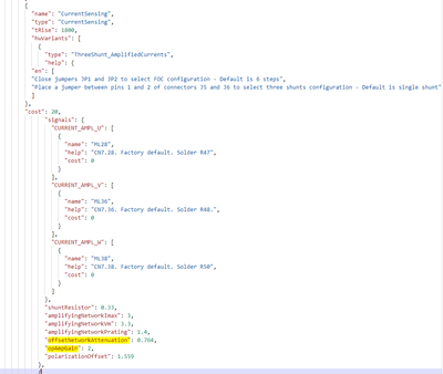

Can't move to 6.2 yet because I cant adjust the current sensing feedback gain as per my custom board.

Hello @Muthanna,
If you started from a ST board, then just clone your board in the Board manager tool and change the gain parameters.

2024-01-11 12:09 AM
Thank you Cedric, The Board Manager was a bit confusing at first, figured it out. Going to make the transition from 5.Y.2 to 6.2.1
