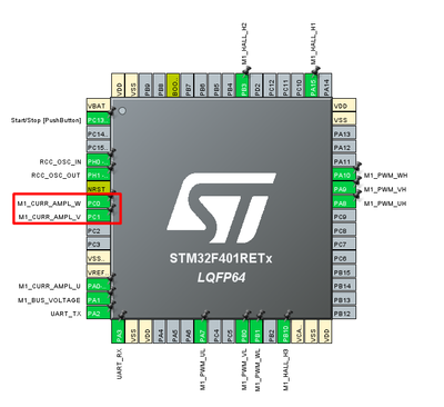

2023-08-18 12:59 PM
Here are the pinout of the Nucleo, and in red are the pins that I'm trying to realocate
2023-08-19 7:36 AM
I'm assuming those pins are used as ADCs. Identify open ADC pins on your new chip and assign those instead. You'll need to change the relevant code such that those pins/channels are used instead of the previous ones, which is likely going to take more work than a few clicks in the GUI.
