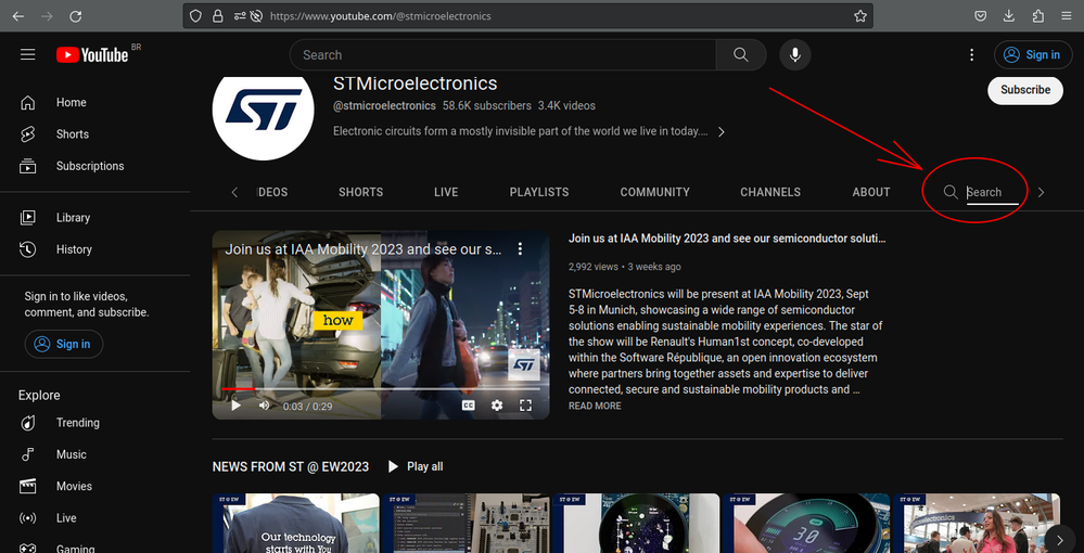

There are many videos on YouTube, have you seen them all? There are videos about Motor Control, about the IDE, about Advanced Debugging and much more.
