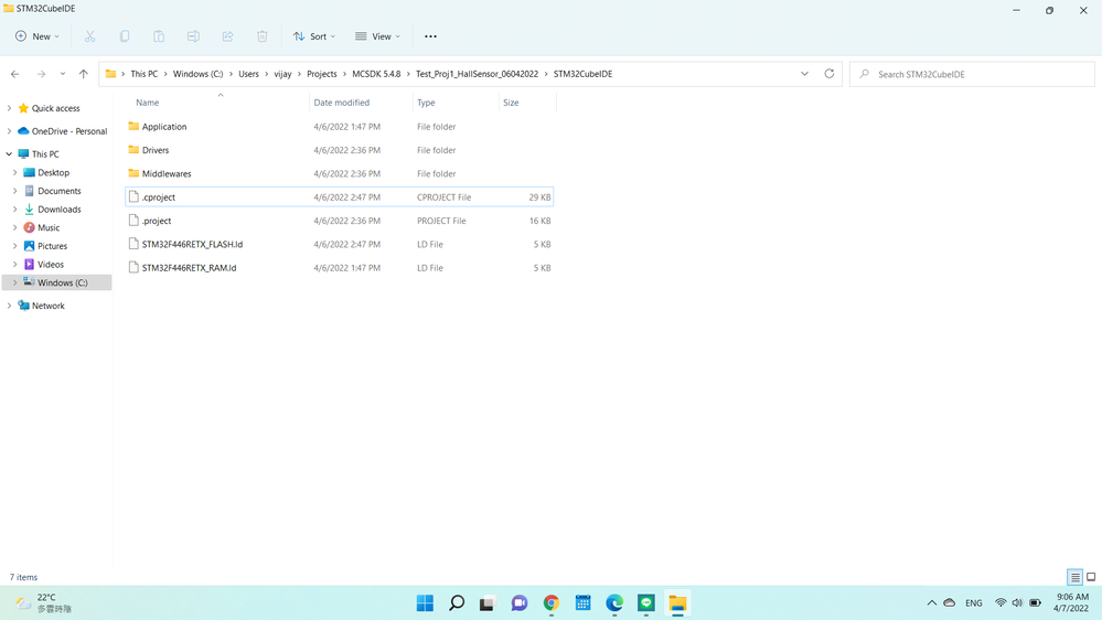

2022-04-06 6:08 PM
Hi @cedric H ,
Cannot open it by double clicking, it doesn't show any suggested IDE icon.
Should i re install again??
2022-04-07 1:29 AM
Hello @hwa,
It looks like your project is corrupted with some files missing.
There are two things possible with the ESC board.
Two examples are provided, one to make use of potentiometer, one to control the speed from a PWM Timer input (basically used by flight controller)
If you want to start from the example, you must select it from the "Example projects" list proposed at the first window. You shall not open the example from the stmcx file. The example flow requires you click on update button at the generation phase.
