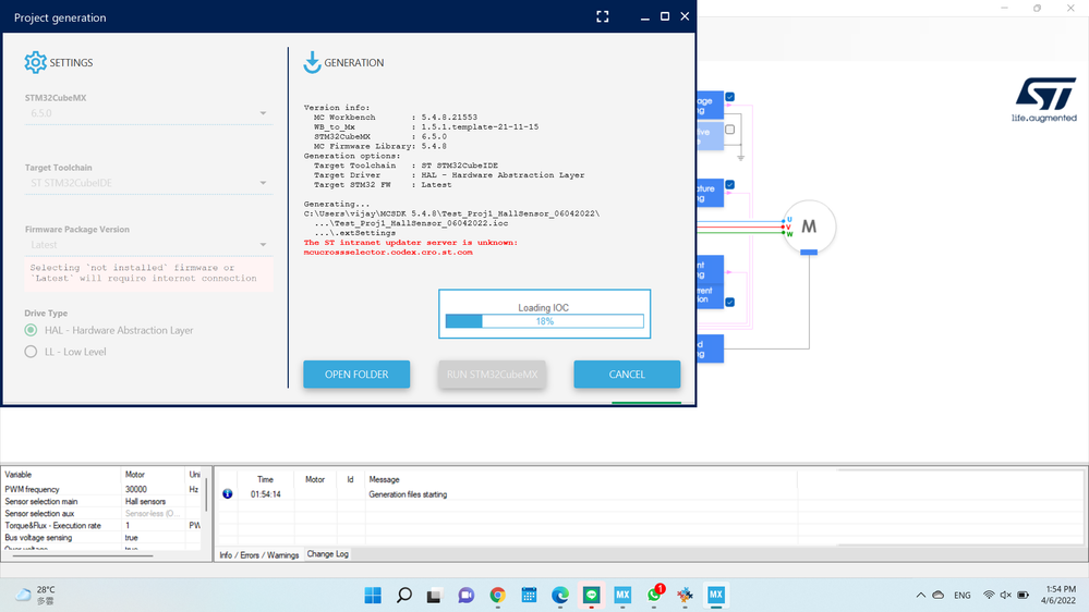

Help! I'm new to ST development tools. All I'm trying to do right now is generate an MC Workbench example project. Any example project.
MC Workbench GENERATION always reports the following error:
"The ST intranet updater server is unknown: mcucrossselector.codex.cro.st.com"
Any suggestions greatly appreciated.
Details:
MotorControl Workbench 5.Y.4 (en.X-CUBE-MCSDK_5.Y.4_v5.5.4.zip)
STM32CubeMX 6.4.0 (en.stm32cubemx-win_v6.4.0.zip)
STM32CubeIDE 1.7.0 (st-stm32cubeide_1.7.0_10852_20210715_0634_x86_64.exe)
(All downloaded and installed yesterday.)
It does generate a CubeMX project, which generates a CubeIDE project, but that source code is has a massive number of undefined symbols. I have not changed any config or preferences settings. It's all "fresh out of the box", and I'm just following the provided instructions.
((Context: I have 2 new B-G431B-ESC1 boards, and started out trying to build the example projects for that board. When that failed, I started trying other examples, and it looks like the problem is a very basic one with MC Workbench, not related to the examples for my specific board.))

2022-04-06 12:17 AM
Helli @cedric H ,
When click on generate, and after all the source files generated. Click on close an error occurs "Generation failed".

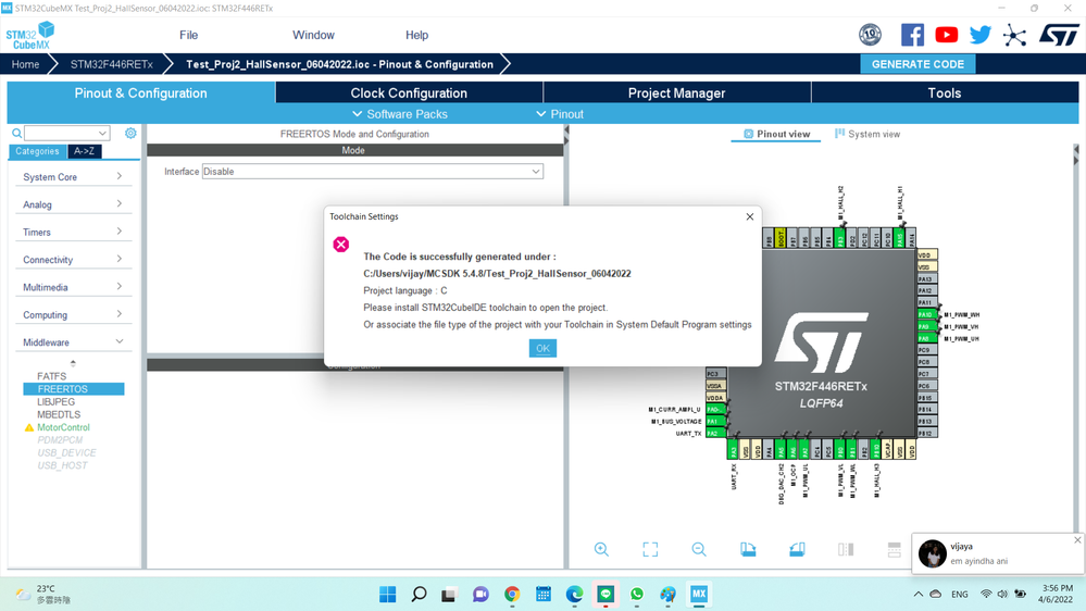

2022-04-06 1:19 AM
Hi @cedric H ,
Opened CubeMX and generated Code, but an error exists. Previously, in older versions, this error doesn't exist.
Help me to solve this issue.
2022-04-06 1:30 AM
@Community member,
I do not see any error in your attached screenshot, the pop-up window states that your code is successfully generated.
You selected the STM32CubeIDE toolchain, and it seems that this toolchain is not installed.
If you want to generate a project for another compiler, you can configure it in "Project Manager" tab.
Or you can download stm32CubeIDE for free here.
Cedric

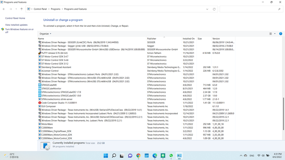

2022-04-06 1:34 AM
Hi @cedric H ,
I already installed latest version, cubeiDE 1.9.0
2022-04-06 2:22 AM
Ok, then you should be able to open your generated project by double clicking on your .cproject file located here : C:\Users\vijay\MCSDK 5.4.8\TestProj1_HallSensor_06042022\STM32CubeIDE
It is weird that cubeMX did not find your cubeIDE installation.
Cedric
