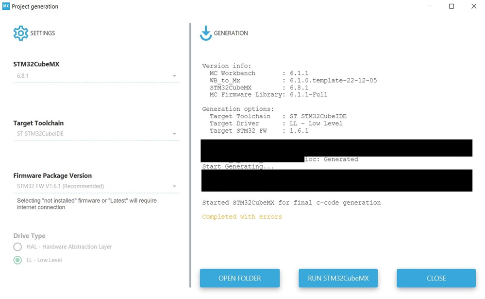

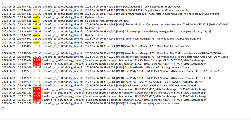

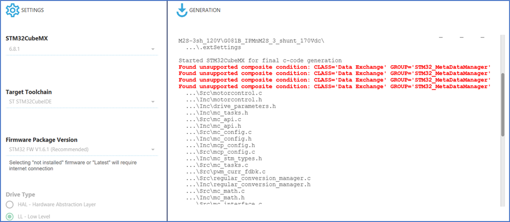

2023-06-06 8:50 AM - edited 2023-11-20 6:33 AM
Thanks Zieb b.
(see the first 2 images below).
(See last image below. )
And in the more detailed log file, no warning and no errors are shown… !?!
....though the final message in the GUI says completed with errors
Thanks anyway Zied !
Log before adding the wb2mx.properties file
Fig1
More detailed log (some lines removed to keep it short) -- before adding the wb2mx.properties file

Log AFTER adding the wb2mx.properties file
Fig3
