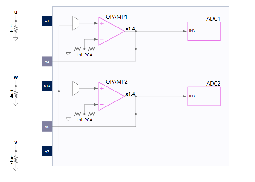

The code uses 3 shunts algorithm in a three shunts topology.
You can see in the picture below (example from MCSDK 6.1.1 ) how the connections are done internally between peripherals when using 2 Opamps and 2 ADCs in three shunt topology. According to the sector, the firmware switches the Opamps inputs to sample two valid currents and reconstruct the third one. At the end of an electrical cycle all three currents are used.
