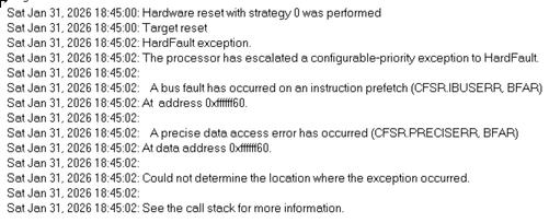

Hi, I'm unable to debug the template project, once debug session is launched the core just stucks in the bootrom:
Also there are some error in the log:
Sat Jan 31, 2026 12:25:55: IAR Embedded Workbench 9.70.2 (C:\iar\ewarm-9.70.2\arm\bin\armproc.dll)
Sat Jan 31, 2026 12:25:55: Loaded macro file: C:\iar\ewarm-9.70.2\arm/config/debugger/ST/STM32N6xx_DBG.dmac
Sat Jan 31, 2026 12:25:55: Loaded macro file: C:\iar\ewarm-9.70.2\arm/config/debugger/ST/STM32N6xx_Trace.dmac
Sat Jan 31, 2026 12:25:55: Loaded macro file: E:\mcu\STM32Cube\STM32Cube_FW_N6_V1.2.0\Projects\STM32N6570-DK\Templates\Template\EWARM\FSBL\setup.mac
Sat Jan 31, 2026 12:25:55: PC-locked license - IAR Embedded Workbench for ARM
Sat Jan 31, 2026 12:25:57: Connected to ST-LINK/V3 [SWD mode 1000 kHz] [Access port: 1] Firmware V3.J17.M10 (Probe no: 002900304142501820353451)
Sat Jan 31, 2026 12:25:57: Hardware reset with strategy 1 was performed
Sat Jan 31, 2026 12:25:57: Initial reset was performed
Sat Jan 31, 2026 12:25:57: DMAC: DBGMCU_APB1LFZR was modified. DBG_WWDG1_STOP bit is set.
Sat Jan 31, 2026 12:25:57: DMAC: DBGMCU_APB4FZR was modified. DBG_IWDG_STOP bit is set.
Sat Jan 31, 2026 12:25:57: DMAC: DBGMCU_CR was changed (old=0x0, new=0x300007)
Sat Jan 31, 2026 12:25:57: Failed to read CPUID for Cortex device
Sat Jan 31, 2026 12:25:57: Loaded debugee: E:\mcu\STM32Cube\STM32Cube_FW_N6_V1.2.0\Projects\STM32N6570-DK\Templates\Template\EWARM\FSBL\Template_FSBL\Exe\Template_FSBL.out
Sat Jan 31, 2026 12:25:57: 9288 bytes downloaded (133.39 Kbytes/sec)
Sat Jan 31, 2026 12:25:57: Download completed.
Sat Jan 31, 2026 12:25:57: Write failed (CPU data abort) at Memory address 0xe000'edfc
Sat Jan 31, 2026 12:25:57: Target reset
Sat Jan 31, 2026 12:25:57: 9288 bytes downloaded (127.75 Kbytes/sec)
Sat Jan 31, 2026 12:25:57: Loaded extra image: E:\mcu\STM32Cube\STM32Cube_FW_N6_V1.2.0\Projects\STM32N6570-DK\Templates\Template\EWARM\FSBL\Template_FSBL\Exe\Template_FSBL.out, image ID 2
Sat Jan 31, 2026 12:25:57: E:\mcu\STM32Cube\STM32Cube_FW_N6_V1.2.0\Projects\STM32N6570-DK\Templates\Template\EWARM\FSBL\setup.mac(16,10): Error: Write error.
Sat Jan 31, 2026 12:25:57: Error while calling macro execUserSetup
Sat Jan 31, 2026 12:25:57: There were 1 error and 3 warnings during the initialization of the debugging session.

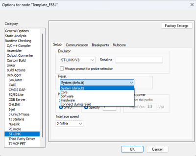

Sorry for this issue. Could you try to change RESET mode in Debugger STLink Options of IAR-EWARM ?
Refer to the screenshot below:
Change Reset to System (default), it will normally fix your issue and halt the cpu in the Reset Handler as defined
in setup.mac (PC at 0x34180404)
For a full debug capabilities, change also the C/C++ optimization from "High Size" to "None" and set a soft break point at the beginning of main.
Let me know if it fix the issue.

Hi @RomainR. , thank you, setting Reset to System (default) indeed solved the issue.
