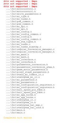

I created a new project in the MC Workbench 6.3.0 and tried generating the project.
Once the generation is completed I recieve the following error message: "Completed with errors."

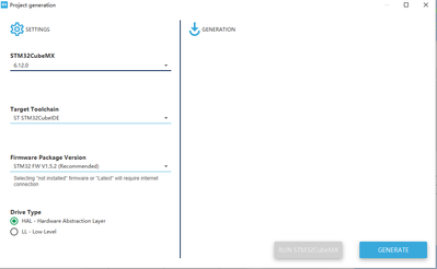

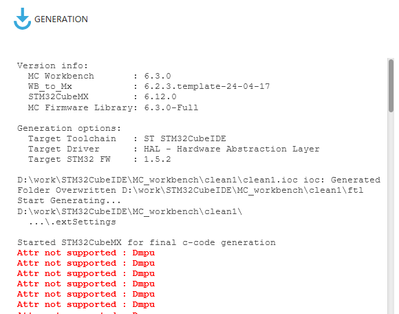

2024-07-11 1:03 AM
Hello Cedric,
I had errors when generate with MC workbench 6.3.0. below is the log. please have a check.
please help.
thanks.
