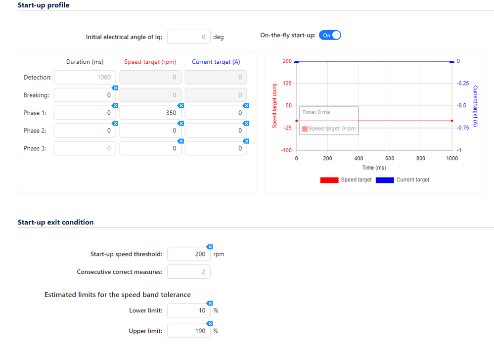

The .stwb6 file is attached (with .txt extension). I modified example control and power boards to match a custom motor driver board so reproduction may not be feasible. It is an FOC project with three shunt resistor current feedback in torque control mode. The "on-the-fly" start up parameters are pictured below. My intention was to have the motor only start up if it was already spinning at least 200rpm, maybe I have done that incorrectly.

It seems that there are two issues here. The first one is that you are experiencing a Start up fault, and it should be possible to solve this via tuning.
However the Start up fault should not be permanent, which is the second issue. I find this one more concerning as it implies an error in the state machine. You mentioned earlier being able to run the project before, could you try to recreate such a project, and try comparing the two of them ? Also, could you tell me what you have changed before re-generating ? Of course, if you could send me the working project for me to also compare them, that would be perfect.
