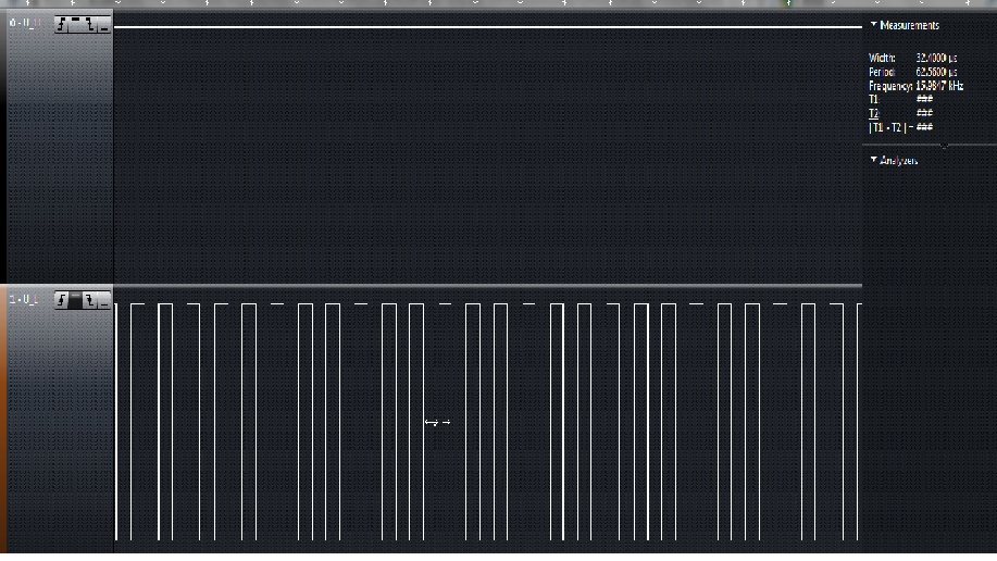

Thank you for your reply,
I have changed the following params in drive parameters.h : /* PWM generation and current reading */ #define PWM_FREQUENCY 16000 #define MAX_MODULATION_100_PER_CENT#define LOW_SIDE_SIGNALS_ENABLING ENABLE
#define SW_DEADTIME_NS 800 /*!< Dead-time to be inserted by FW, only if low side signals are enabled */ #define HIGH_SIDE_IDLE_STATE TURN_OFF /*!< TURN_OFF, TURN_ON */ #define LOW_SIDE_IDLE_STATE TURN_OFF /*!< TURN_OFF, TURN_ON */ #define CURR_SAMPLING_TIME 1 /*!< Sampling time duration in ADC clock cycles (1 for 1.5, 7 for 7.5, ...) */ but I have always the same signals when I'm looking on JP1 et JP6 (on steval ifn003v1) You'll find a print screen with the two signals Regards,2012-11-14 2:00 AM
Ciao
I have the suspect that you are using the STM32 FOC lib. 3.0 with the STEVAL-IFN003V1 firmware patch. In that case the#define LOW_SIDE_SIGNALS_ENABLING ENABLE
is skipped by the patch. So I suggest you to go back to the original version of v3.0 (before patch) or pass to the new v3.2. Ciao Gigi2021-06-27 9:14 PM
