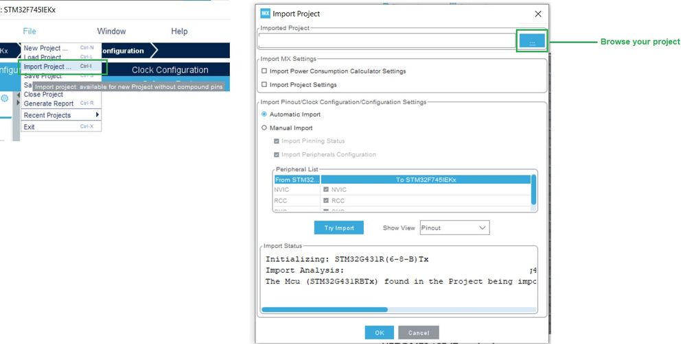

If you're asking about exporting a project created with an STM32G431 on  STM32F745 or STM32F769 using STM32CubeMX tool, I can suggest the " Import Project " solution.
In fact, Import Project menu imports a previously-saved configuration to another MCU. By default the following settings are imported:
  • Pinout tab: MCU pins and corresponding peripheral modes. The import fails if the same peripheral instances are not available in the target MCU.
  • Clock configuration tab: clock tree parameters.
  • Configuration tab: peripherals and middleware libraries initialization parameters.
  • Project settings: choice of toolchain and code generation options.
You’ll find linked Here the User Manual of STM32CubeMX for more details about all the tool feature.
