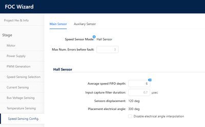

2025-10-09 5:14 AM
Hello @CWern.1,
Could you decrease the Average speed FIFO depth to 6?
