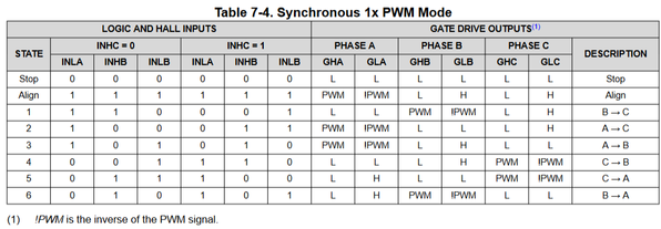

I'm trying to implement 6-step BLDC commutation with an STM32F767 MCU, commutation table shown below
I have the 3 hall effects going to GPIO interrupt pins, the ISR code is pasted below. I used the generated code from the X-CUBE Motor workbench as a starting point for how to properly enable/disable the PWM lines.

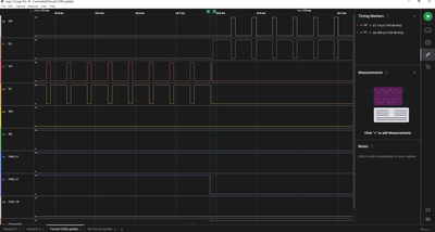

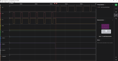

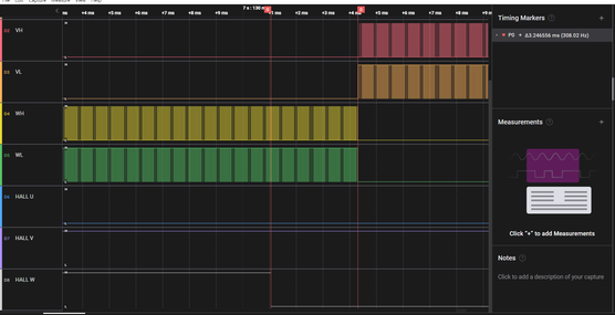

Overall the code works properly, however it takes longer than expected for the complementary PWM lines to shut off after the interrupt. As you can see in the code I've tried manually creating an update event, as well as using the forced inactive mode instead of disabling the channels. The above combination is the best so far but 3ms still seems excessively slow. Is there something else I can do to achieve faster shutoff (as well as startup) of the PWM channels in my ISR?

My issue turned out to be with my GPIO interrupt settings, not the timer. I thought I had the interrupts set to trigger on both rising and falling edges but they were incorrectly set to only trigger on rising edges. With that resolved my timing is much improved.
I also think I should have used a COM event rather than an update event to try and force the change. I've run the code with and without the event and it does not seem to make a difference
With manual COM event
Without manual event
