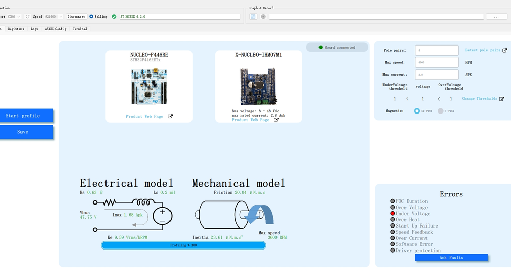

Yes,it works better. It can work in 48V now.:grinning_face::grinning_face:

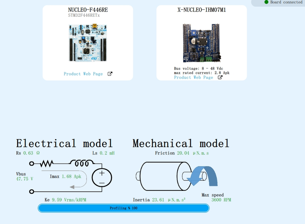

I want to kown how to calculate the Ke.
I refer here:https://wiki.stmicroelectronics.cn/stm32mcu/wiki/STM32MotorControl:How_To_manually_configure_the_motor_parameters
Below is the profiler's result. Ke=9.59 Vrms/kRPM.

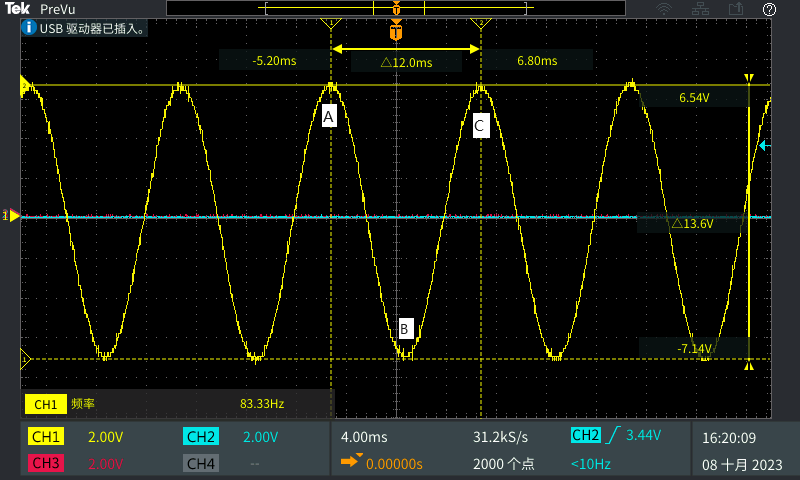

Below is my owm test.
Vpp=13.6v,pole pairs=5,fbemf=83.33Hz. Ke=(13.6*5*1000)/(2√2*83.33*60)=4.8085 Vrms/kRPM.
I wonder if I chose the wrong frequency?Is it between point A and point B or pointA and pointC?Thanks.
