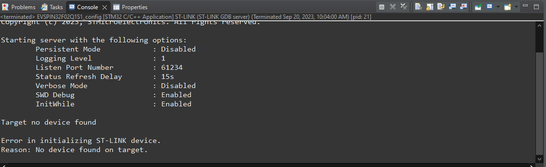

I recently purchased EVSPIN32F02Q1S1 and attempted to flash it with the FOC firmware generated through MotorControl Workbench 6.1.2. However, I was unable to upload the code onto the board and instead greeted with the following message in CubeIDE:
The message was seen when I hit the debug button.
I triple-checked the HAL and code generations from MC and CubeMX to ensure the code being debugged had no problem. I believe this is likely to be a hardware issue since I was able to flash other EVSPIN32F02Q1S1 with the same computer. Then I noticed that when I plug in the "faulty" EVSPIN32F02Q1S1, I see this fail text file:
