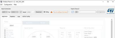

2023-10-16 11:51 PM
Hi,thank you. When I am trying to connect with GUI Iam facing the following issue. Although my communication port and baud rate are correct.
2023-10-17 1:21 AM

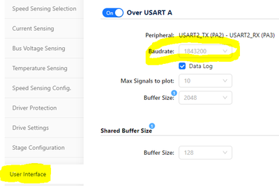

Hello, could you please use the MC Pilot version launch from Workbench:
and set appropriate baud rate according to the value set here:
Please also check the port com by unplugging and plugging in your board.
Best regards
2023-10-17 4:44 AM
Hi thank you.But my issue still not resolved.I tried in all the ways you have mentioned but still not connecting. Also tell me about the jumper connections in control and power board whether it may affect the connection.
