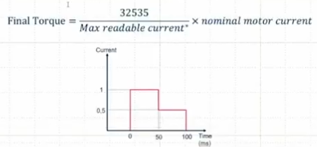

I try to run PMSM motor with Steval-HKI001V2 board. Unfortunately, this board does not support motor profiler software, so I measured the motor parameters manually.
I watched all the Motor Control online video courses and configured the drive parameters, sensors, and start-up parameters. After many days of trying to spin the motor with different start-up parameters I have achieved the following result: I'm able to align the rotor and spin it smoothly to the final ramp speed of 700rpm but then the motor just stops with "start-up" failure.
As I noticed in FAQ start-up failure often occurs when the current is too low, but after increasing the current to 8A, the motor is clogging near 600rpm and then a "speed feedback" error occurs.
What could be the reason for such behavior?
