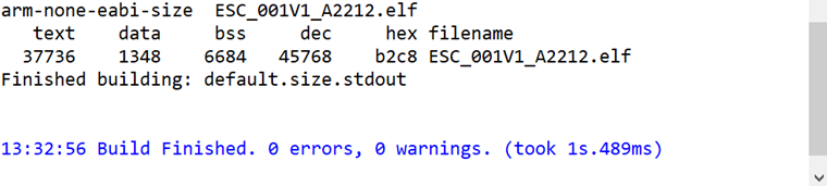

I am currently working on a motor control project using an STM32 microcontroller and STM32CubeIDE. I have noticed that the code size (firmware image size) is larger than expected, and I would like to reduce it as much as possible to fit within memory constraints and improve performance.
Are there recommended methods or best practices to optimize the firmware code and reduce its size?
At present, the firmware size is:

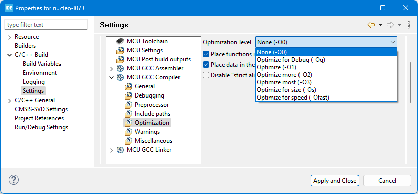

First, what compiler optimisation setting are you currently using?
The default is None:
As a first step, try 'Optimise for Debug (-Og)' - which is designed to give a decent compromise between optimisation and debuggability
GCC Optimisation levels are documented here:
https://gcc.gnu.org/onlinedocs/gcc/Optimize-Options.html

> At present, the firmware size is: ...
ELF is not a good representation of Flash usage, and can contain a lot of meta and debug information.
I don't use/know CubeIDE, but other IDEs create nice bar charts for Flash/RAM usage, with details for every section.
Alternatively, check the map file, or add a post-build step to convert it to a *.hex / *.s19 file.

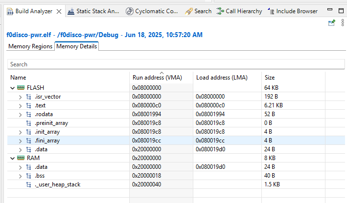

That's true, but the figures @Vats-ab showed do relate to the binary image size:
These figures don't include the ELF metadata.
@Ozone wrote:other IDEs create nice bar charts for Flash/RAM usage, with details for every section.
CubeIDE provides that in the Build Analyser - mentioned earlier.

Hello @Vats-ab,
By default, the Motor Control-generated IDE project uses the -Ofast optimization setting. Does using the -Os or -Oz optimization setting improve the size figure?
