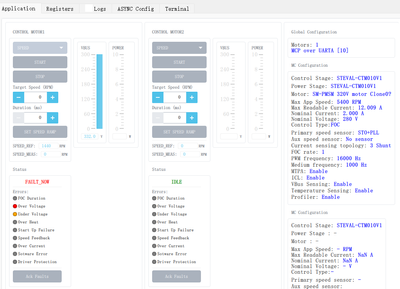

Why is the bus voltage remain about 330v when motor max-voltage is changed to 280v ?

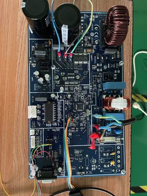

the attchment is the status of Motor Pilot based on STEVAL-CTM010V1 .

When Bus voltage sensing is enabled as it is your case for Motor 1, the value is read from the board and does not depend on the motor max-voltage.
How is your board powered?

The power input is 220VAC 50HZ .
So could you tell me how can I get a 280v bus voltage ?
2025-06-25 10:49 PM
So steval_ctm0101v1 does not support 280V BLDC motor because of OVER VALTAGE ?
2025-06-26 12:19 AM - edited 2025-06-26 12:49 AM
Just exactly how do you think this thing would be able to make a 280V bus voltage with a 220VAC input?
