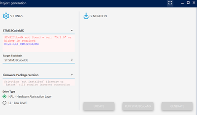

I found out that the original firmware was built using Motor Control Workbench 5.4.8. I have the .stmcx file and can load it. When I try a generate I get an error that STM32CubeMX not found - ver. "5.2.0" or higher is required.
However I have STMCubeMX 6.14.1 installed. Any ideas why it cant find it?

Hello @GMA,
I have the STM32CubeMX software installed. Its the latest version 6.14.1. The problem is that the MotorControl Workbench tool v 5.4.8 does not find it installed.

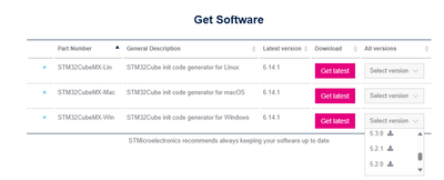

Hello @DKM
I would advise you to test with STM32CubeMX v6.4.0. which is the recommended version for the MCSDK 5.4.8.
Regards
Cedric
2025-05-30 11:01 AM
The installer for this version crashes and the installation does not complete.
