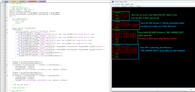

I checked the state of both motors, and the phenomenon was as follows:
Given the identical input, the output varies wildly. I can't figure out why.
Could you give me some advice?
Thank you.
(The following is the code I added. The log file can be found here: GitHub - ShadowThree/dbger)

I never worked with dual motors but my suggestion would be to make one motor running smoothly without any faults and then go for dual motors testing.
Verify the threshold levels of fault parameters of voltages,
Verify the current sensor circuitry.
Record the voltages and currents and check them for valid ranges.
