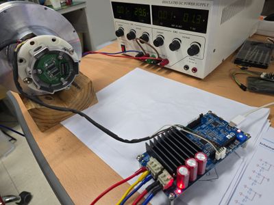

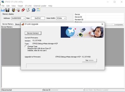

After purchasing EVSPIN32G4, I only updated ST-LINK after connecting Micro USB.
It is connected to the motor as shown below.
The board cannot be connected in ST Motor Pilot.
How do I connect?
