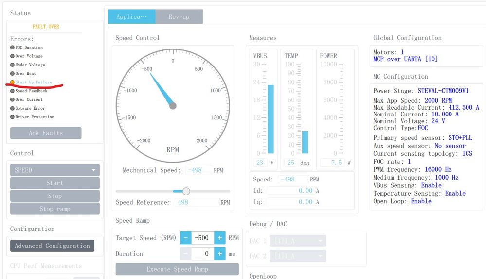

Hello Everybody,
Here are the software and boards in this case:
1. MC workbench 6.3.2
2. STEVAL-IHM039V1/STEVAL-CTM009V1
I have an I-PMSM motor, and I use the board (STEVAL-IHM039V1/STEVAL-CTM009V1) to run the ST Motor Pilot for spinning the motor. However, when I try to use the senseless mode, it always reports an error "Start up failure". Should I make some other configuration in ST Motor Pilot? Thanks!
2025-12-03 9:49 AM
The starting point is always to verify the documentation for the startup failure reasons.
2025-12-05 12:58 AM
Hello @DF_MC,
For Error description and management, refer to documentation available through "Workbench tool">About>Documentations>Documentation>"User manual" tab, "(FOC) Firmware errors" link.
