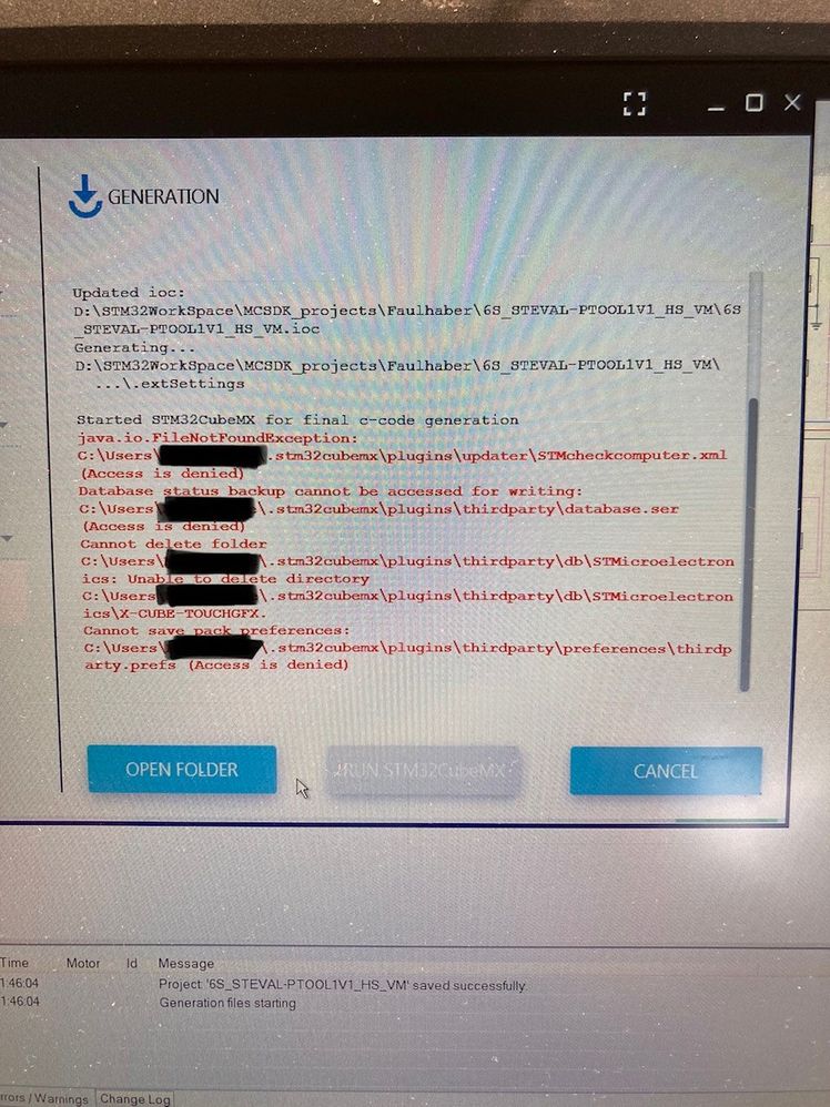

Hello @BPara.1,
Thank you for posting on the community forum,
I could only reproduce the issue you encountered by denying permissions to the ".stm32cubemx" folder. Could you please check if you have full control allowed on that folder ? If so please check the existence of the files mentioned in the error message and update me with your findings.
