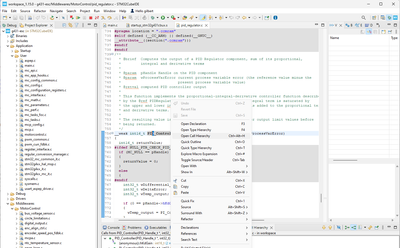

Using STM32CubeIIDE, right click on function and select "open call hierarchy".
On "Call Hierarchy", you can select "Show Callers" ot "Show Calles".
