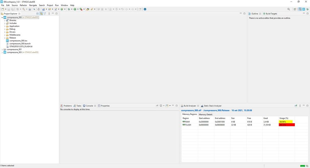

Dear all, if the answer at my above question is:"YES" and the available space is already full...does is there a compatible chip with larger memory? or did I make some mistake? any suggestions?
See below pict for better understanding

Hello @Cpiac.1 and welcome to the ST Community.
The picture is missing ;)
However, which IDE are you using?
2021-09-17 5:01 AM
I'm using STM32CubeIDE 1.6.1.

Hi @Cpiac.1 ,
please could you attach the picture above mentioned.

Hi @Cpiac.1,
are you using the HAL APIs?
A first step of optimization could be use the Low Layer APIs in the ST Motor Control Workbench.
In addition you can use the compiler optimization in the STM32CubeIDE.
Since your question is about STM32 MCSDK, I added the topic "STM32 Motor Control" user of this community are experts of ST Workbench and can help you.
Anyway, I can suggest as an alternative the last SIP STSPIN32G4 that embeds STM32G431 MCU (128 kB Flash memory).
