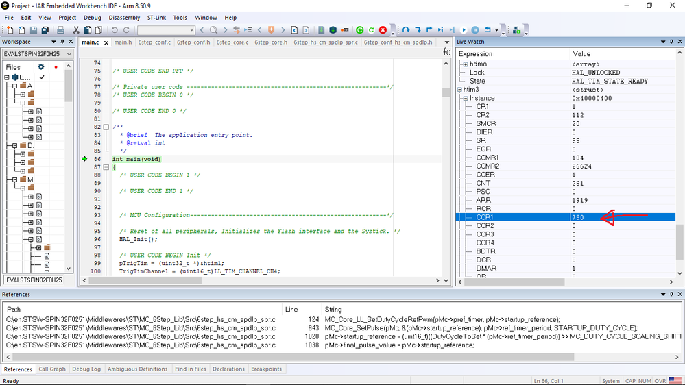

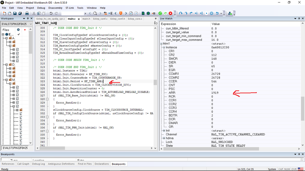

So I presently have this problem. As seen in the picture, my timer1 time base is set to 1919 and it has a 48MHz clock source, which means I should produce signals with frequency of 25kHz. But this is not the case. instead the output signals from the timer is about 1.2kHz.
What could possibly be wrong? How is it possible that the timebase is set to 1919 for a 48MHz clock source and it doesnt produce the right 25kHz frequency?

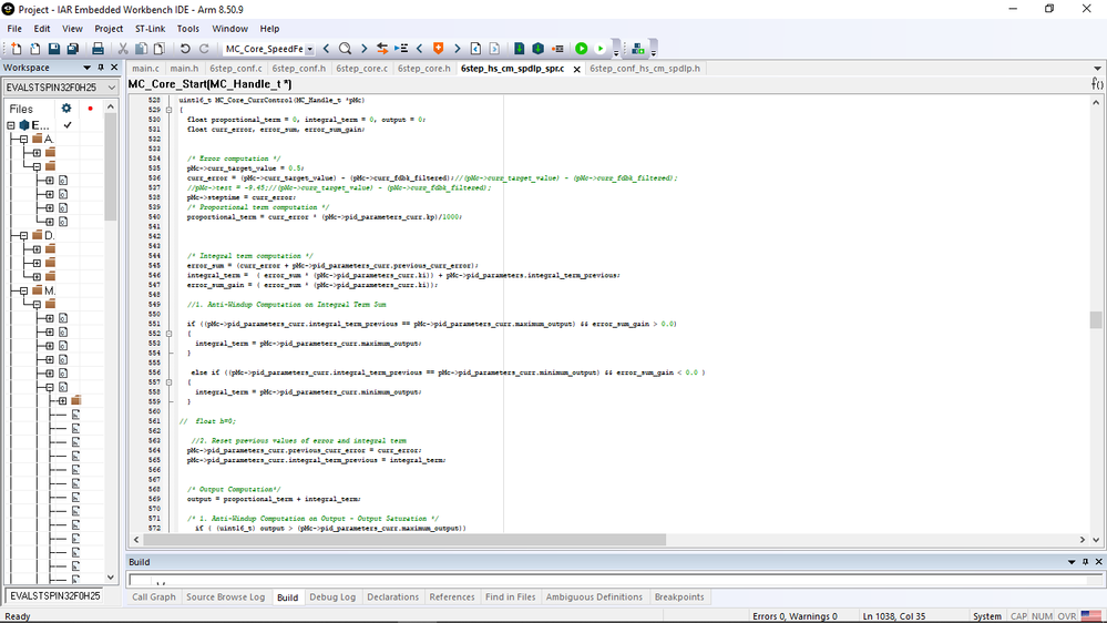

I have a control function to set the duty cycle, the duty cycle is then written to the CCR1-3 of the timer1's channels 1-3. The duty cycle is produced by the PI control function that takes in the feedback dc current and the Reference current. As shown in this picture.
The control function itself is executed whenever the HAL_SYSTICK_Callback() function is called which should be every 21ns since the system clock is 48MHz.
The weird thing is that I set another timer (Timer3) to have the same ARR/frequency as this timer and also to have the same Dutycycle as this timer(Timer1). And I get the exact frequency and duty cycle on Timer 3 but not timer 1, as can be seen in the image below. The value of CCR(750) and ARR(1919)
I hope this makes sense.

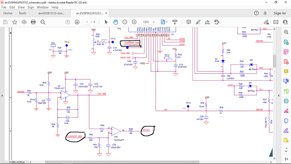

I think this might be the problem: So from the image below. The Signal from CPOUT is used to clear the TIM1's Channel 1-3 OCREF whenever it goes high. So basically it serves as TIM1's ETR clearing source.
Also, the signal CurrentRef is the signal produced from TIM3. It was the one I set to have the same frequency and duty cycle as the TIM1.
The thing now is, I no longer want to use the signal from CPOUT to clear the TIM1's OCREF signals, so I simply commented out those parts in the TIM1 initialization function. Maybe this is the problem?
I have attached the TIM1 initialization function below. Where I set the clearconfig typedef variable to 0 and then commented out the parts that initializes the clearconfig variables.
* @brief TIM1 Initialization Function
* @param None
* @retval None
static void MX_TIM1_Init(void)
/* USER CODE BEGIN TIM1_Init 0 */
/* USER CODE END TIM1_Init 0 */
TIM_ClockConfigTypeDef sClockSourceConfig = {0};
TIM_ClearInputConfigTypeDef sClearInputConfig = {0};
TIM_SlaveConfigTypeDef sSlaveConfig = {0};
TIM_MasterConfigTypeDef sMasterConfig = {0};
TIM_OC_InitTypeDef sConfigOC = {0};
TIM_BreakDeadTimeConfigTypeDef sBreakDeadTimeConfig = {0};
/* USER CODE BEGIN TIM1_Init 1 */
/* USER CODE END TIM1_Init 1 */
htim1.Instance = TIM1;
htim1.Init.Prescaler = HF_TIMX_PSC;
htim1.Init.CounterMode = TIM_COUNTERMODE_UP;
htim1.Init.Period = HF_TIMX_ARR;
htim1.Init.ClockDivision = TIM_CLOCKDIVISION_DIV1;
htim1.Init.RepetitionCounter = 0;
htim1.Init.AutoReloadPreload = TIM_AUTORELOAD_PRELOAD_DISABLE;
if (HAL_TIM_Base_Init(&htim1) != HAL_OK)
Error_Handler();
sClockSourceConfig.ClockSource = TIM_CLOCKSOURCE_INTERNAL;
if (HAL_TIM_ConfigClockSource(&htim1, &sClockSourceConfig) != HAL_OK)
Error_Handler();
if (HAL_TIM_PWM_Init(&htim1) != HAL_OK)
Error_Handler();
// sClearInputConfig.ClearInputState = DISABLE;
// sClearInputConfig.ClearInputSource = TIM_CLEARINPUTSOURCE_NONE;
// sClearInputConfig.ClearInputPolarity = TIM_CLEARINPUTPOLARITY_NONINVERTED;
// sClearInputConfig.ClearInputPrescaler = TIM_CLEARINPUTPRESCALER_DIV1;
// sClearInputConfig.ClearInputFilter = 8;
if (HAL_TIM_ConfigOCrefClear(&htim1, &sClearInputConfig, TIM_CHANNEL_1) != HAL_OK)
Error_Handler();
if (HAL_TIM_ConfigOCrefClear(&htim1, &sClearInputConfig, TIM_CHANNEL_2) != HAL_OK)
Error_Handler();
if (HAL_TIM_ConfigOCrefClear(&htim1, &sClearInputConfig, TIM_CHANNEL_3) != HAL_OK)
Error_Handler();
sSlaveConfig.SlaveMode = TIM_SLAVEMODE_RESET;
sSlaveConfig.InputTrigger = TIM_TS_ITR1;
if (HAL_TIM_SlaveConfigSynchronization(&htim1, &sSlaveConfig) != HAL_OK)
Error_Handler();
sMasterConfig.MasterOutputTrigger = TIM_TRGO_OC4REF;
sMasterConfig.MasterSlaveMode = TIM_MASTERSLAVEMODE_ENABLE;
if (HAL_TIMEx_MasterConfigSynchronization(&htim1, &sMasterConfig) != HAL_OK)
Error_Handler();
sConfigOC.OCMode = TIM_OCMODE_PWM1;
sConfigOC.Pulse = 0;
sConfigOC.OCPolarity = TIM_OCPOLARITY_LOW;
sConfigOC.OCNPolarity = TIM_OCNPOLARITY_HIGH;
sConfigOC.OCFastMode = TIM_OCFAST_DISABLE;
sConfigOC.OCIdleState = TIM_OCIDLESTATE_RESET;
sConfigOC.OCNIdleState = TIM_OCNIDLESTATE_RESET;
if (HAL_TIM_PWM_ConfigChannel(&htim1, &sConfigOC, TIM_CHANNEL_1) != HAL_OK)
Error_Handler();
if (HAL_TIM_PWM_ConfigChannel(&htim1, &sConfigOC, TIM_CHANNEL_2) != HAL_OK)
Error_Handler();
if (HAL_TIM_PWM_ConfigChannel(&htim1, &sConfigOC, TIM_CHANNEL_3) != HAL_OK)
Error_Handler();
sConfigOC.OCPolarity = TIM_OCPOLARITY_HIGH;
if (HAL_TIM_PWM_ConfigChannel(&htim1, &sConfigOC, TIM_CHANNEL_4) != HAL_OK)
Error_Handler();
sBreakDeadTimeConfig.OffStateRunMode = TIM_OSSR_DISABLE;
sBreakDeadTimeConfig.OffStateIDLEMode = TIM_OSSI_DISABLE;
sBreakDeadTimeConfig.LockLevel = TIM_LOCKLEVEL_OFF;
sBreakDeadTimeConfig.DeadTime = 0;
sBreakDeadTimeConfig.BreakState = TIM_BREAK_ENABLE;
sBreakDeadTimeConfig.BreakPolarity = TIM_BREAKPOLARITY_LOW;
sBreakDeadTimeConfig.AutomaticOutput = TIM_AUTOMATICOUTPUT_DISABLE;
if (HAL_TIMEx_ConfigBreakDeadTime(&htim1, &sBreakDeadTimeConfig) != HAL_OK)
Error_Handler();
/* USER CODE BEGIN TIM1_Init 2 */
#if (CURRENT_MODE != 0)
LL_TIM_DisableBRK(htim1.Instance);
#endif
LL_TIM_OC_SetDeadTime(htim1.Instance, DEAD_TIME);
/* USER CODE END TIM1_Init 2 */
HAL_TIM_MspPostInit(&htim1);
