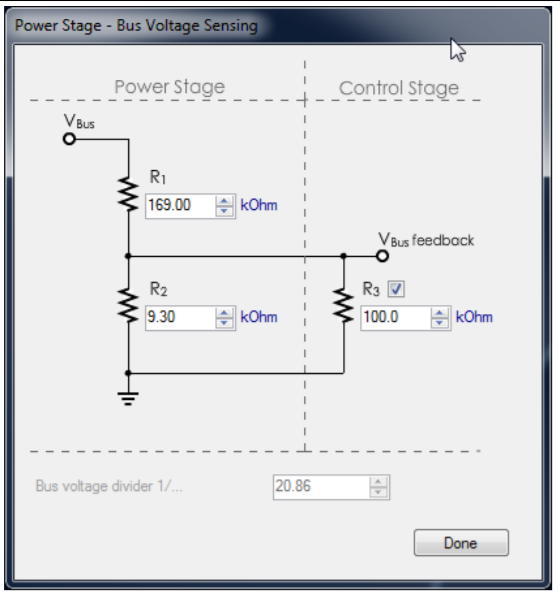

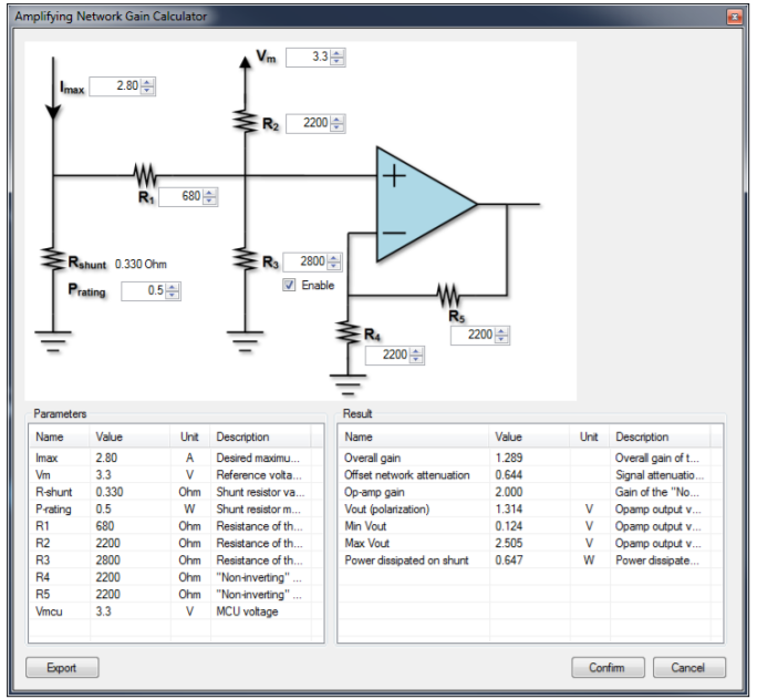

I am using NUCLEO-F303RE,
I have purchased a power board (IPM evaluation board EVALM13645ATOBO1) from Digikey.
Is automatically calculated? or Is the user needs to configure this value?
If yes, where or how to find/check these values? 3. is it possible to change the board details once it is selected.
