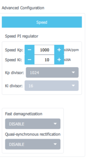

Concerning your 6STEP issue, I believe it can be solved by tinkering a bit the PID values, something like that worked on my end :
You can see those options by clicking the Advanced Configuration button on the bottom left of the Pilot.
