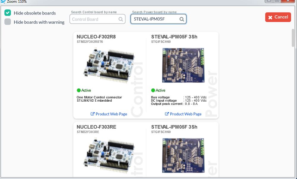

Hey. When will it be possible to add the EVSPIN32F0601S3 board to the ST Motor Profiler? Or which one to choose from the proposed for determining the parameters of the electric motor?
2020-08-27 7:13 AM
Hi @SLodo.1 , unfortunately the EVSPIN32F0601S3 is not supported by the motor profiler.
However you can collect the motor characteristics using the STEVAL-IPM05F as power board.

2021-05-10 9:30 AM
Hi @Enrico Poli (ST Employee) , SLodo.1 (Community Member)
Which combination should I use for EVSPIN32F0601S3 in Motor Profiler 5.4.6?
How the hardware ( Nucleo Board + STEVAL-IPM05F) will be identical/matched with EVSPIN32F0601S3 to Run Motor Profiler ?
or you suggest buy another board?
Thanks in advance ..

2021-06-27 10:18 PM
Any pair of equipment can be used (also in conjunction with nucleo 103). The choice of power section depends on the capacity and power supply of your drive. Then you can use EVSPIN32F0601S3 to mcwb to create a project with parameters from Motor Profiler.
