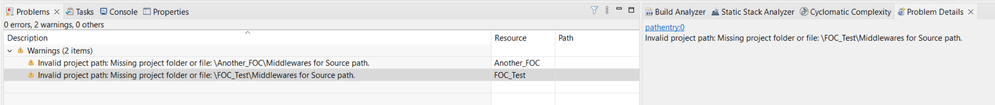

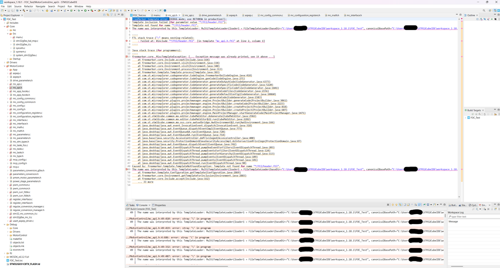

I got several FreeMarker template errors when I tried to compile the code to test out EVLSPIN32G0A1. It looks like all the files under MotorControl folder were affected by what I assume is the same error type (see attached picture).FreeMarker template error. The steps to reproduce this error are as shown below.

Hello @Bam,

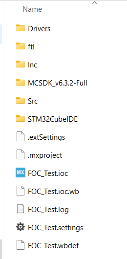

Have you generated your project from Motor Control Workbench or from CubeMx tool? It is mentioned in the log that one file is missing (header.ftl). Could you check that "ftl" directory is present on your project directory (at same level as "Src" and "Inc").

Hello @Bam,
Yes, or from the Workbench tool, saving your project with another name to start with a new project directory. "ftl" directory and its files are generated by Workbench Tool (it is not the case if you load an ioc with CubeMx tool and generate the code).

The new project gave the same warning.
