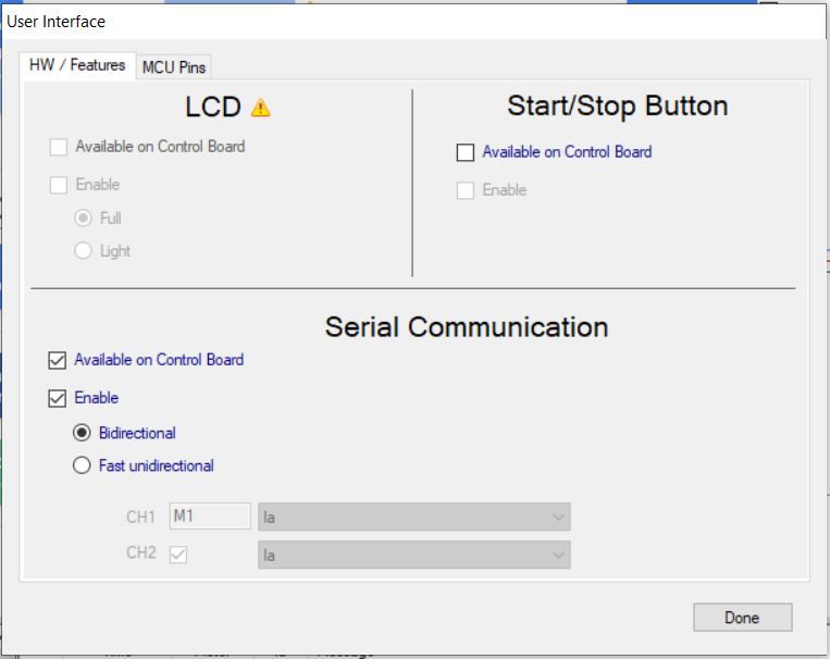

> 2. Related to this suggested user code for “stm32f0xx_mc_it.c�?, there is no /* USER CODE END START_STOP_BTN */ i
This is because the button is not selected in the User interface

"Check that the UART is properly enabled in the User Interface box." I made no changes to these parameters for the sample, so it's as delivered. Does it seem correct to you?

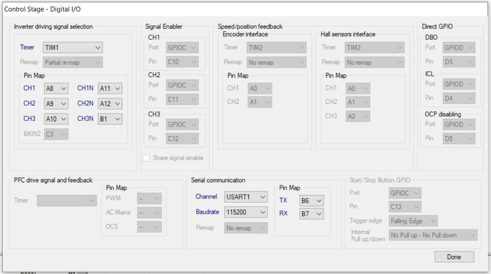

"Check that the UART is well configured in the Digital I/O box". I made no changes to these parameters for the sample, so it's as delivered. Does it seem correct to you?

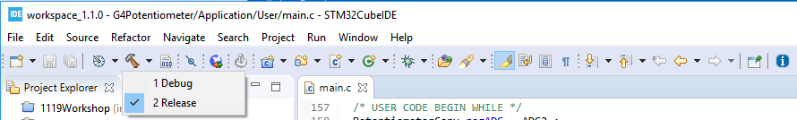

For the STEVAL-ESC001V1 issue, in STM32CubeIDE, you have to build your project in Release mode.
There is, as the image below, a contextual menu allowing you to choose between Debug or Release mode.
The correct optimization level is set in Release mode (Optimize for speed).
This menu is accessible through the little arrow at the right of the hammer.
