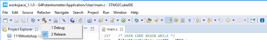

If you look at the image below, you will see a contextual menu allowing you to choose between Debug or Release mode.
The correct optimization level is set in Release mode.
This menu is accessible through the little arrow at the right of the hammer.
Let me know if it fixes your issue.

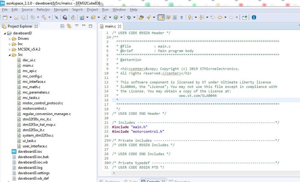

I now have the latest of everything, have meticulously followed the process MCSDK, CUBEMX, CUBEIDE generating a new project into a new blank folder in my "mydocuments" and can report...
It couldn't import the project still, and has the can't build hammer greyed out error. If I try to import it, it doesn't recognise the project atall, and if I click the .project file, it opens in CUBEIDE but can't build. Come on guys... This is getting silly. Can still import a TrueStudio project in the same way and it works. This is your flagship software, and it can't recognise its own generated code.

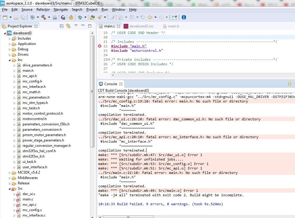

So restarting CUBEIDE, adding an arbitrary GPIO and regenerating made the hammer appear.
But now it can't build because it can't find main.h and a load of other arbitrary yet important things that are clearly there...
