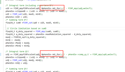

Does the HSO algorithm in FOC support IPMSM motors? I see that in the MCSDK software, i can select IPMSM, but the generated code does not include ld and lq. Does this mean the HSO algorithm can only be used with SPMSM?

hello:
Thank you very much for your response, but I still don't understand why in the current loop control of the current loop, there is no need to distinguish between ld and lq to control the DQ axes separately? Or is it that your algorithm is different from the usual FOC current loop framework?

Hello propu,
This is a big subject, but I will try to summarise as best as I can.
You could technically have 2 different parameters for d & q, but usually this complicates matters for little gain.
Let's keep in mind here that the main objective is to keep the system stable. Now looking at your current PI controller, your w_i depends on your inductance value, which is different for d & q, correct.
However, having one value for both doesn't hinder your stability, as long as you use the smallest of the two inductances for your computation. That way, you will always have enough margin to ensure stability, even on the direction your inductance is incorrect. This of course also depends on your Kp gain, which we choose such as to keep sensitivity down.
