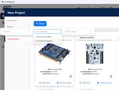

2024-12-03 6:10 AM
Hello @kamalskdy,
Selecting 2 motors on Workbench "General Info" tab, and inverter, Inverter tab displays the list of dual drive capable inverter boards.
Selecting "Modular" option, on "Control board" tab, click on "Filters" button and select "2 connectors at least" on "N. of connectors".
