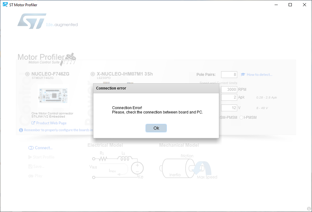

I use Nucleo-F746ZG, X-Nucleo-IHM07M1 and Maxon motor (https://www.maxongroup.com/maxon/view/product/motor/ecmotor/ecflat/ecflat45/668555). These boards were purchased separately.
Motor Profiler and Motor Pilot give a connection error. CubeIDE connects and flashes the board without problems.
After two days of attempts, I realized that I can connect only in STLINK mode (it does not connect via UART).

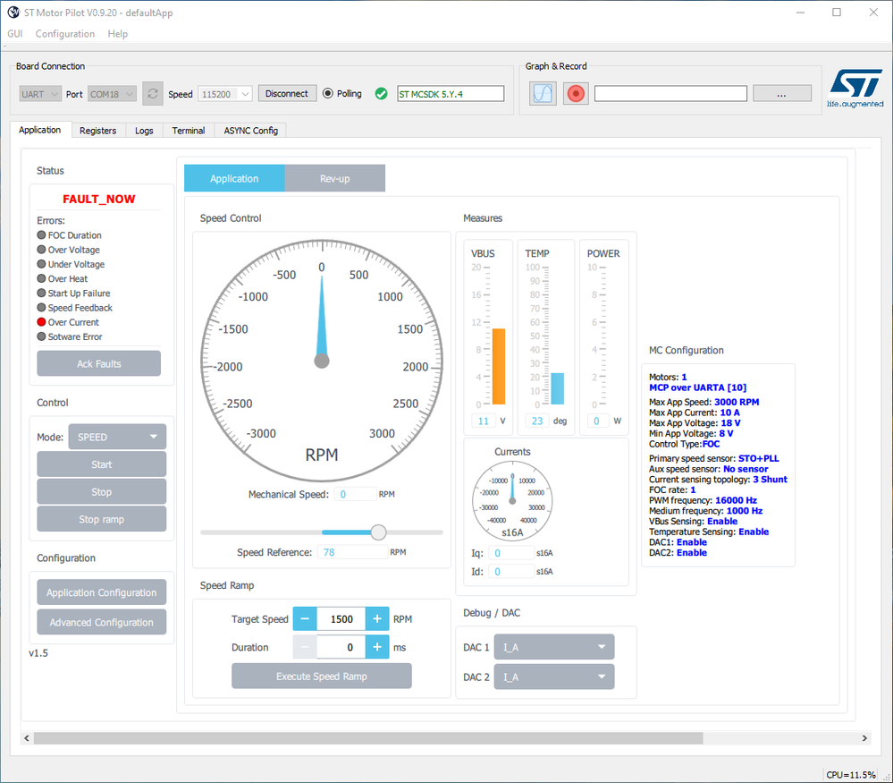

Another day later, I generated the firmware using MotorControl Workbench and installed it using CubeIDE. In the firmware, the port speed was set to 115200.
Now the Motor Pilot was able to connect via UART, but he still cannot control the motor.
The manual say that before testing the motor, the Motor Profiler installs the firmware necessary for its operation on the board, but it seems to me that this is not so.
Now I lean towards the fact that I need a basic firmware for STM32 to test the motor.
