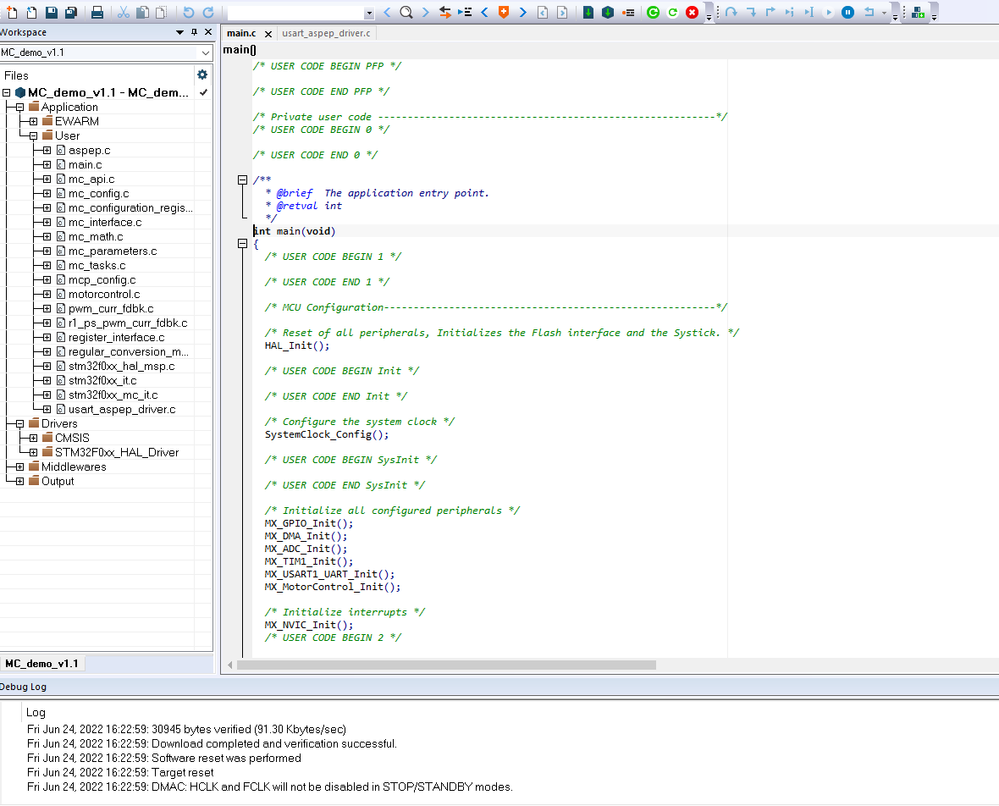

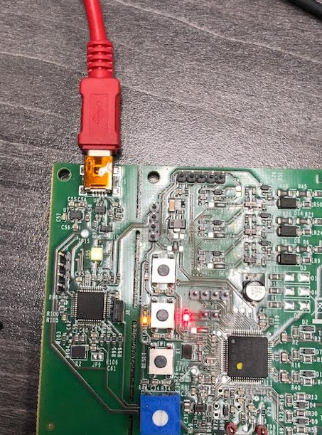

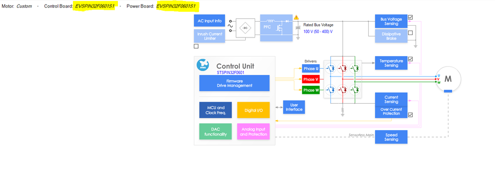

Hi, I'm new to the STMicroelectronics environment and I'm having issues with the EVSPIN32F0601S1 development board. I'm trying to spin a motor but I'm having issues connecting the evaluation board to the Motor Pilot GUI. I followed the video from the DevCon 2020 presentation video, but I'm getting a "Port open and try to configure the board" message from the Motor Pilot GUI.
My work flow goes as follows:
Here are some images, hopefully they help.
